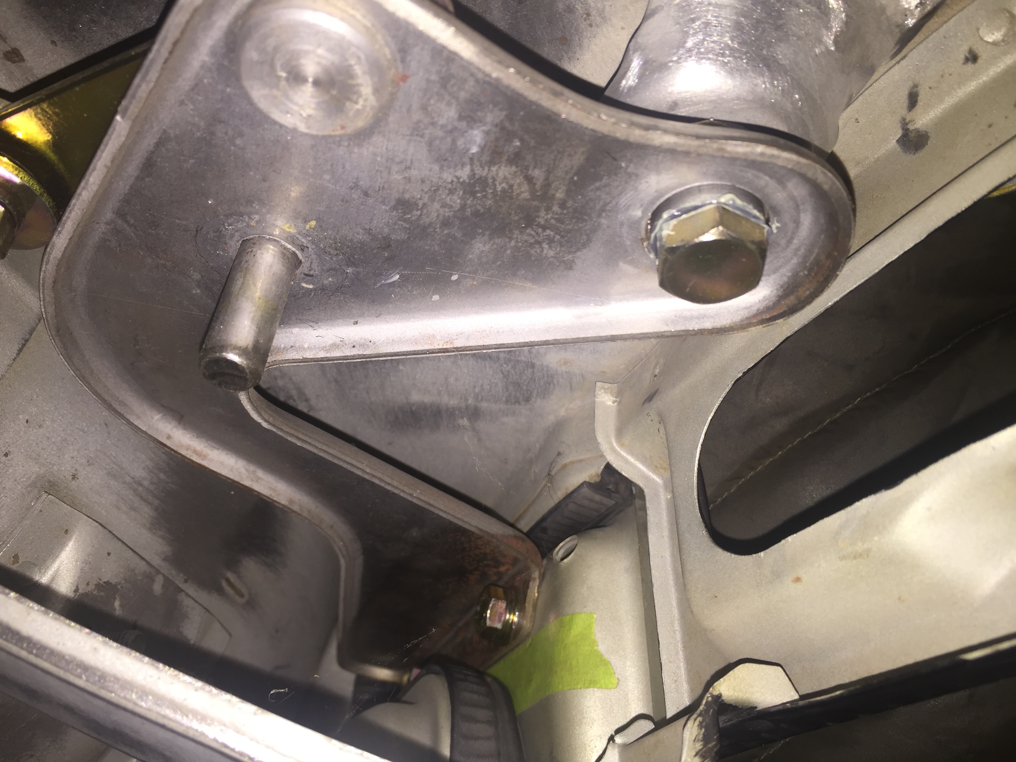

My trunk opens (& always has) into the small grill sections either side of the decklid.
rubber mark has some angled rubbers for a bracket in this area but i cannot find in google images any pictures with this bracket fitted.
Can someone show me this on their car?

I have included some pics of a car at CAMP. Plus a loose hinge showing the flat metal strap.
Craig at CAMP
