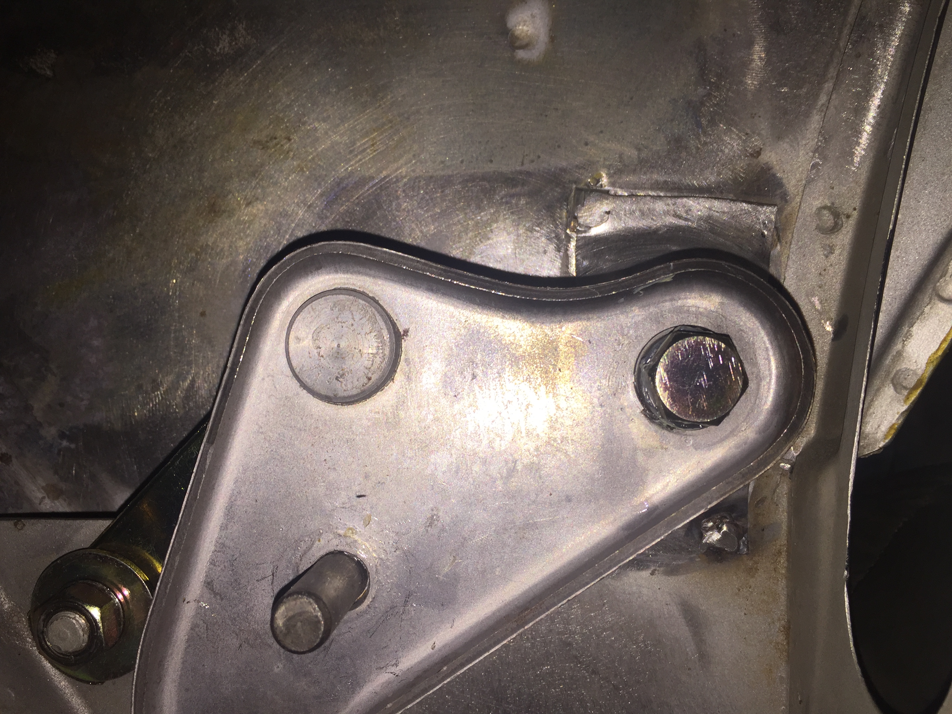

My trunk opens (& always has) into the small grill sections either side of the decklid.
rubber mark has some angled rubbers for a bracket in this area but i cannot find in google images any pictures with this bracket fitted.
Can someone show me this on their car?

theer   I think the angled rubber piece you mention is the...   Mar 6 2018, 02:35 PM
Mikey914   I'll post up some pictures here for clarificat...   Mar 6 2018, 03:45 PM
UROpartsman   Are you talking about the little rubber bumpers in...   Mar 6 2018, 04:08 PM
Olympic 914   That L-shaped piece only comes into play if you op...   Mar 6 2018, 05:30 PM
JFG   Perfect pictures to identify the rubbers that mark...   Mar 7 2018, 03:03 PM
boxstr   I just looked at a rear trunk lid on the car and r...   Mar 7 2018, 03:55 PM

Bobco   I had the same problem on my 71.I even had new piv...   Mar 7 2018, 04:25 PM
JFG   I had the same problem on my 71.I even had new pi...   Mar 8 2018, 01:48 AM
Mikey914   I have the deck lid bumper. If it's the L shap...   Mar 8 2018, 01:09 AM
Mikey914   As well as the ones that go on the hinges. https:...   Mar 8 2018, 01:12 AM

Mikey914   By the way both of the pics are my part I can tell...   Mar 8 2018, 01:14 AM

Mikey914   The hinges on the deck lid can be bend slightly to...   Mar 8 2018, 10:06 AM
boxstr   Okay, to get away from the URO pissing match. I lo...   Mar 8 2018, 03:34 PM
jcd914   It looks to me like the hinge pivots may have been...   Mar 8 2018, 03:38 PM
Mikey914   I'm redoing my deck lid on the 72 this next we...   Mar 8 2018, 03:47 PM
JFG   More advice and opinions on this problem. The t...   Mar 9 2018, 01:13 AM
Mikey914   here's a picture of mine. It was properly adju...   Mar 9 2018, 03:47 AM
Mikey914   The pictures aren't great as I didn't inte...   Mar 9 2018, 03:50 AM
boxstr   I have included some pics of a car at CAMP. Plus a...   Mar 9 2018, 01:57 PM
JFG   Thanks mark but they're the wrong points/hinge...   Mar 9 2018, 01:58 PM

Root_Werks   Pics Craig at CAMP Reviving an older thread. ...   Mar 11 2022, 07:02 PM
Superhawk996   Pics Craig at CAMP Reviving an older thread. ...   Mar 12 2022, 09:04 AM
Root_Werks   [quote name='Root_Werks' post='2987423' date='Mar...   May 10 2022, 12:00 PM
Mikey914   Sorry im way off   Mar 10 2018, 10:19 AM
Root_Werks   Posting an update to this thread. Pulled the limi...   May 10 2022, 11:58 AM
Root_Werks   If anyone embarks on making the strap travel short...   May 12 2022, 11:30 AM
