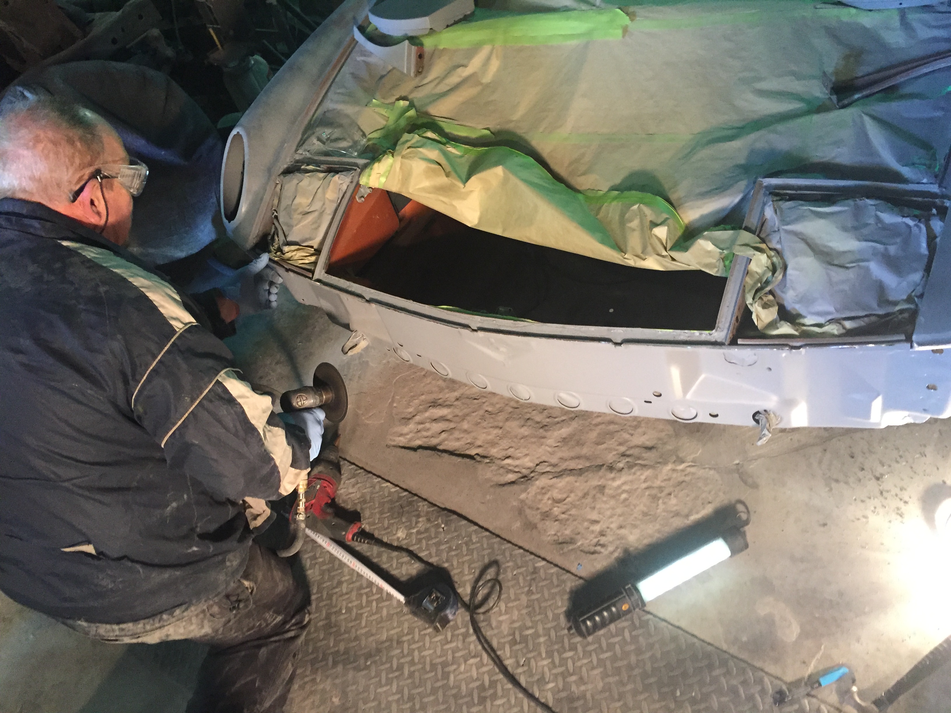

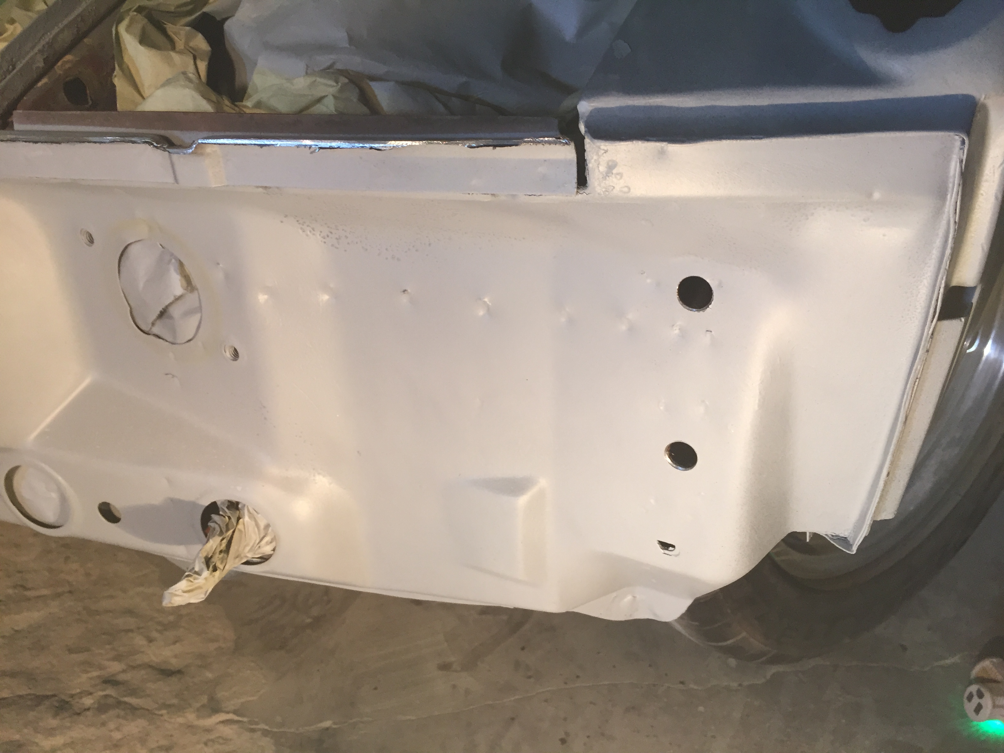

Philip W.   did the back date work on the car today- front was...   Mar 10 2018, 05:06 PM
Philip W.   holes primmed ans side brackets taken off, ground ...   Mar 10 2018, 05:08 PM
Philip W.   boy these fenders look great! almost done- Mik...   Mar 10 2018, 05:13 PM
Philip W.   other side- - thats it until i get the tin back in...   Mar 10 2018, 05:15 PM
