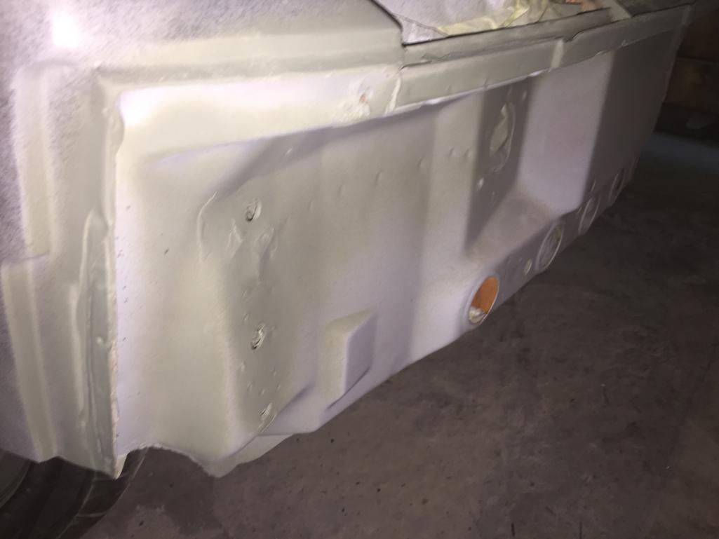

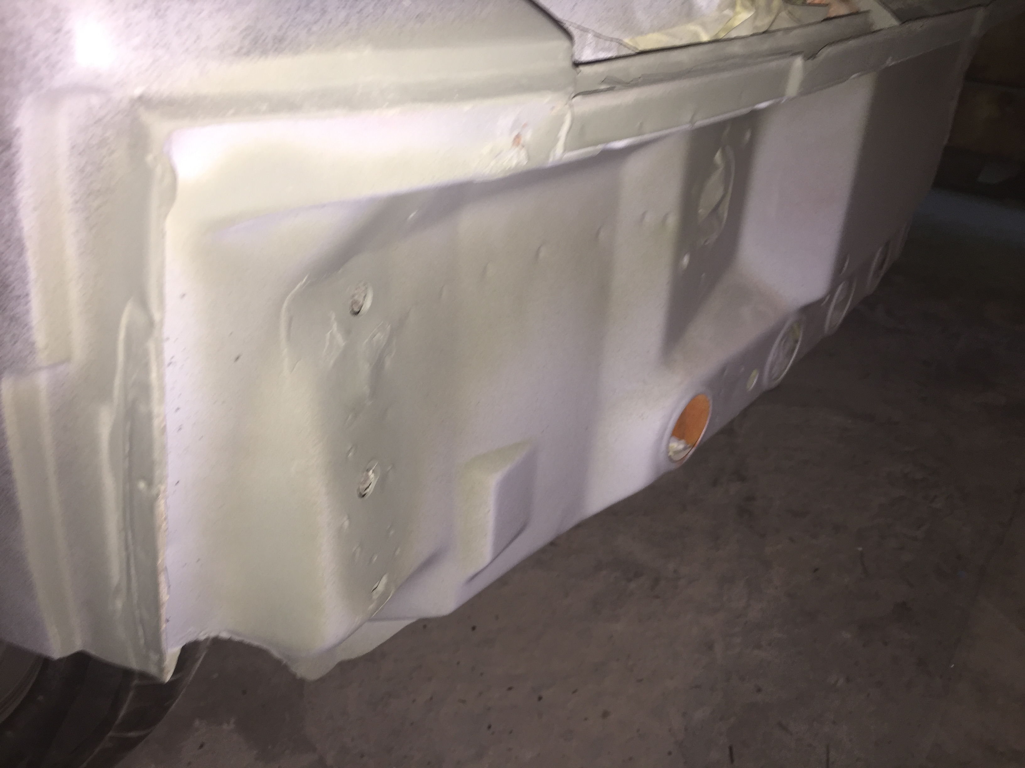

holes primmed ans side brackets taken off, ground down the weld spots and primed

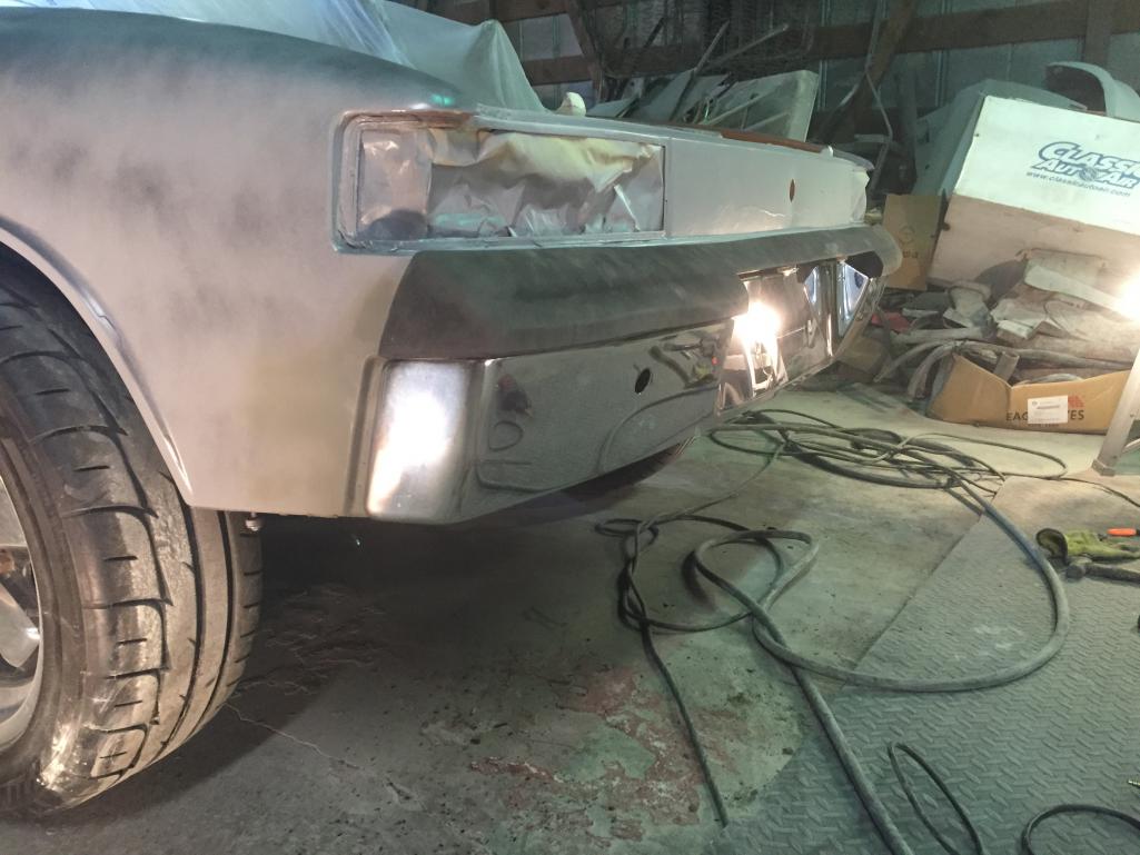

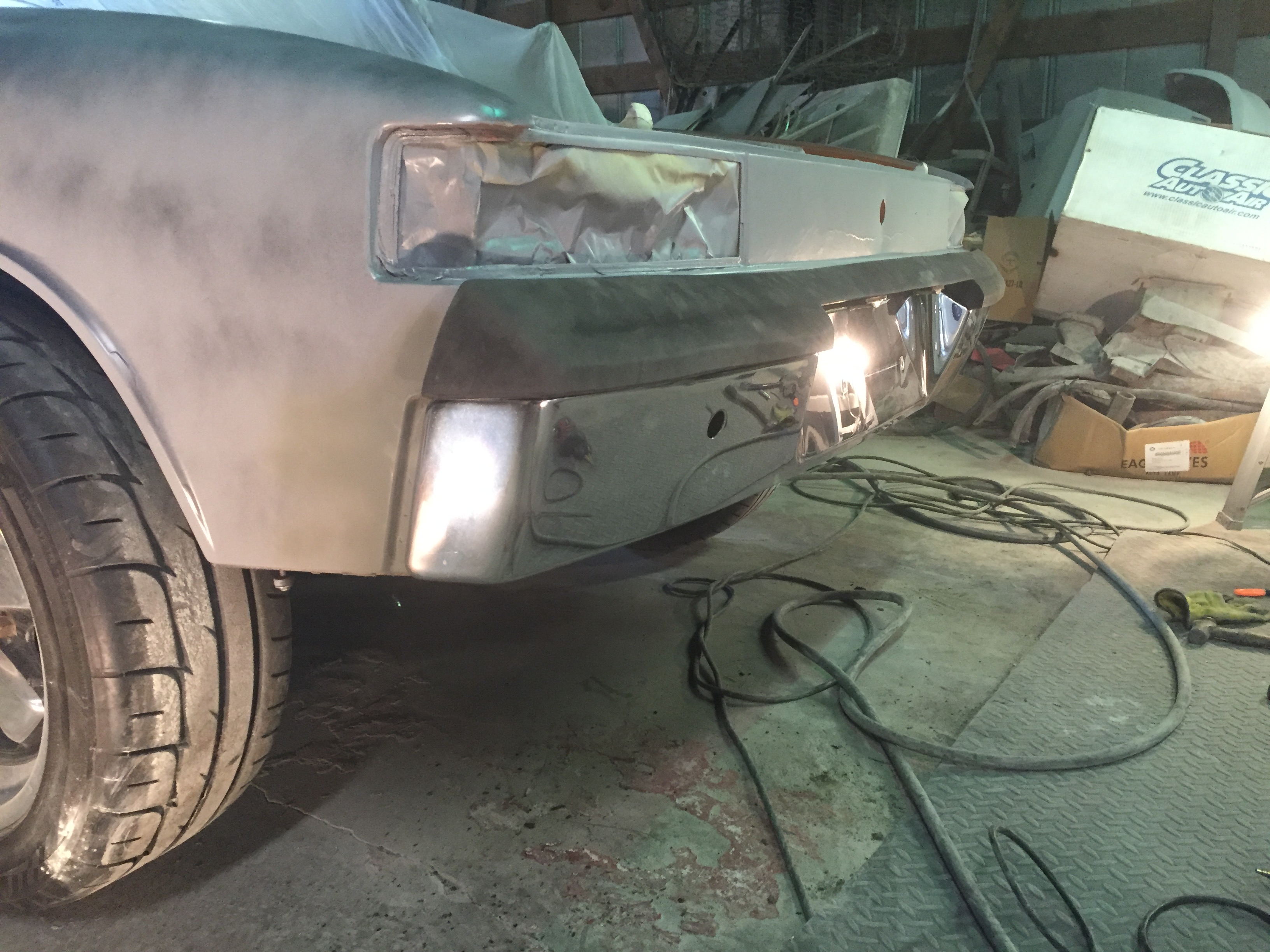

Philip W.   did the back date work on the car today- front was...   Mar 10 2018, 05:06 PM
Philip W.   holes primmed ans side brackets taken off, ground ...   Mar 10 2018, 05:08 PM
