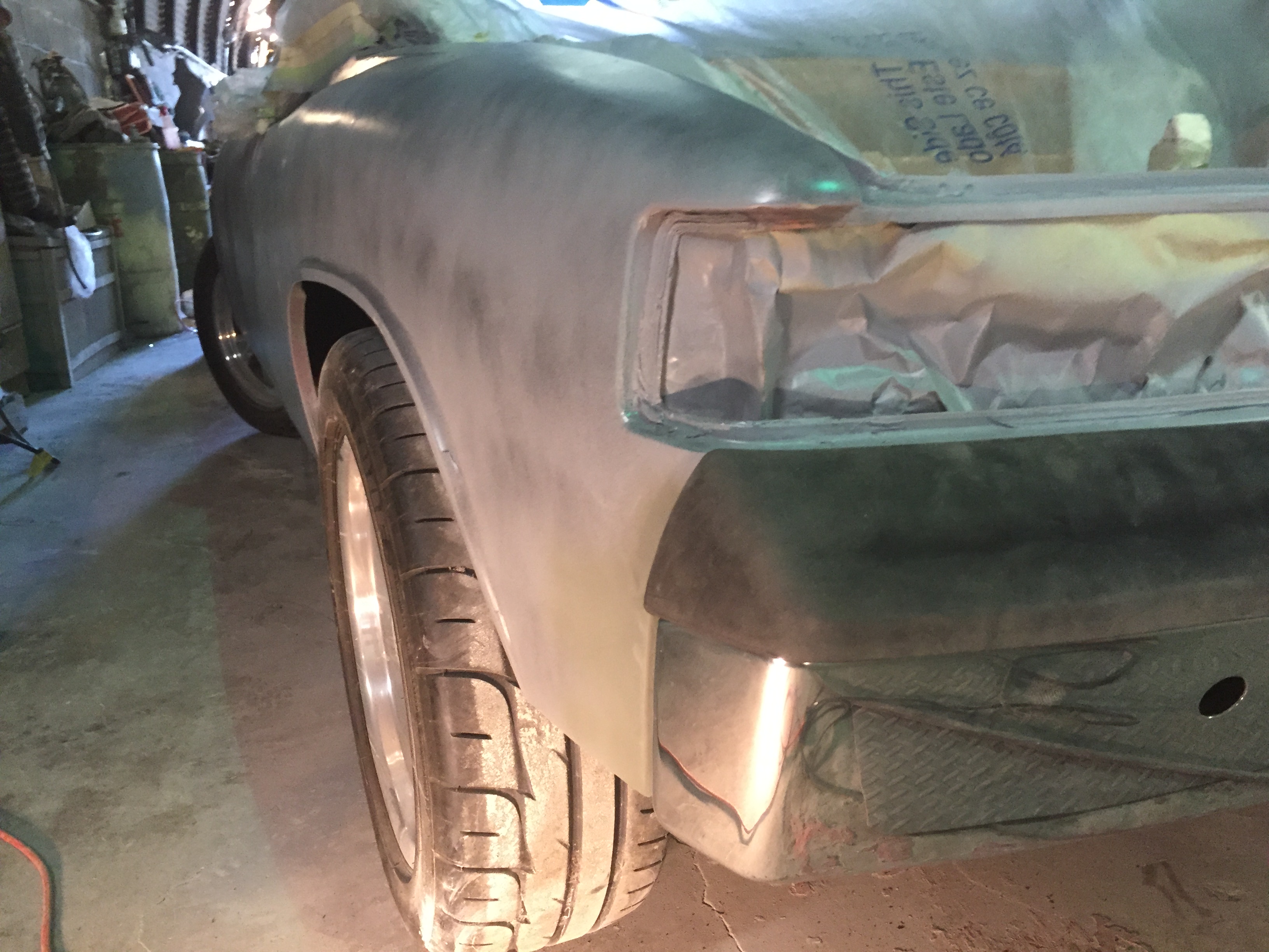

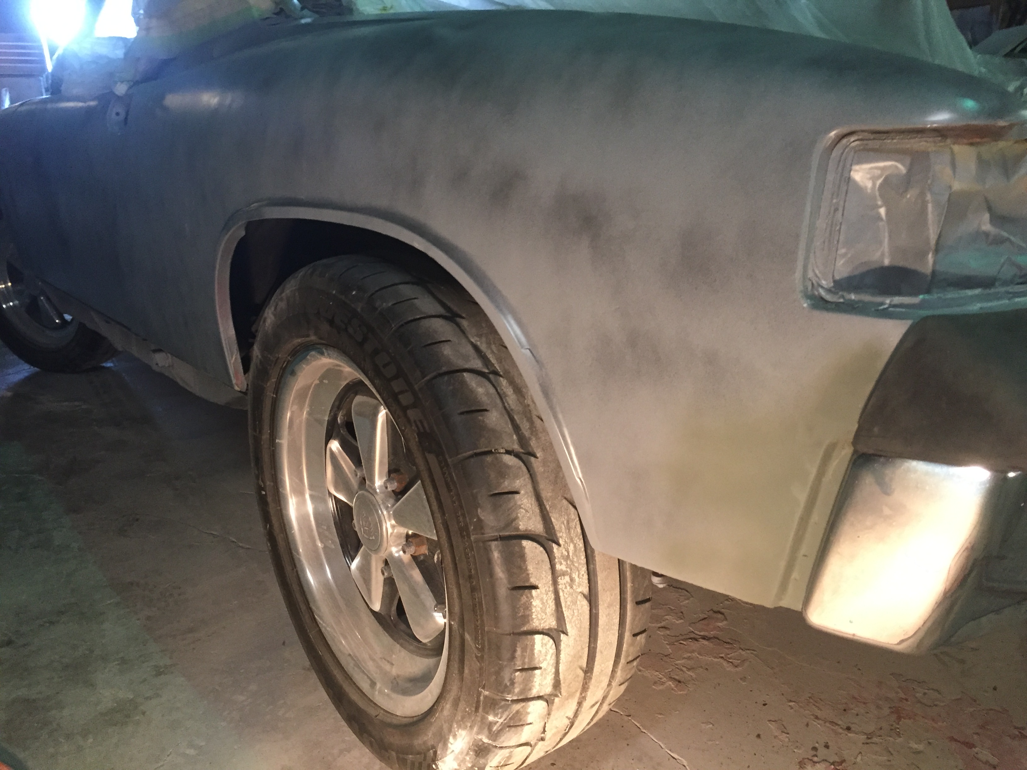

boy these fenders look great! almost done- Mike did a great job this was all hammer and dolly work, no filler- just good metal work and had been primed and sanded, has some high build primer on there, one more pass then the under side gets prepped for texture and paint- thats next week, then the base and clear on the outside in 2 !
