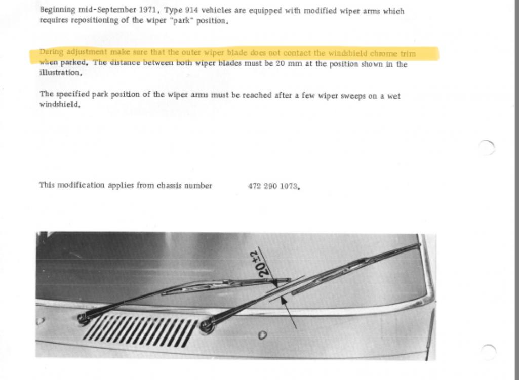

I see mucho driver's side windshield trim overlap. Is this the factory setting?

QUOTE(windforfun @ Mar 13 2018, 09:15 PM) *
No this is the factory setting:

QUOTE(Firstcar @ Mar 13 2018, 10:17 PM) *
This is good info. Looks "funny" tho, so I am guessing not very many folks have them adjusted like this.
I like my drivers wiper to be a bit longer and stop a bit shorter. It does touch the trim. Looks like it touches the trim here too.
