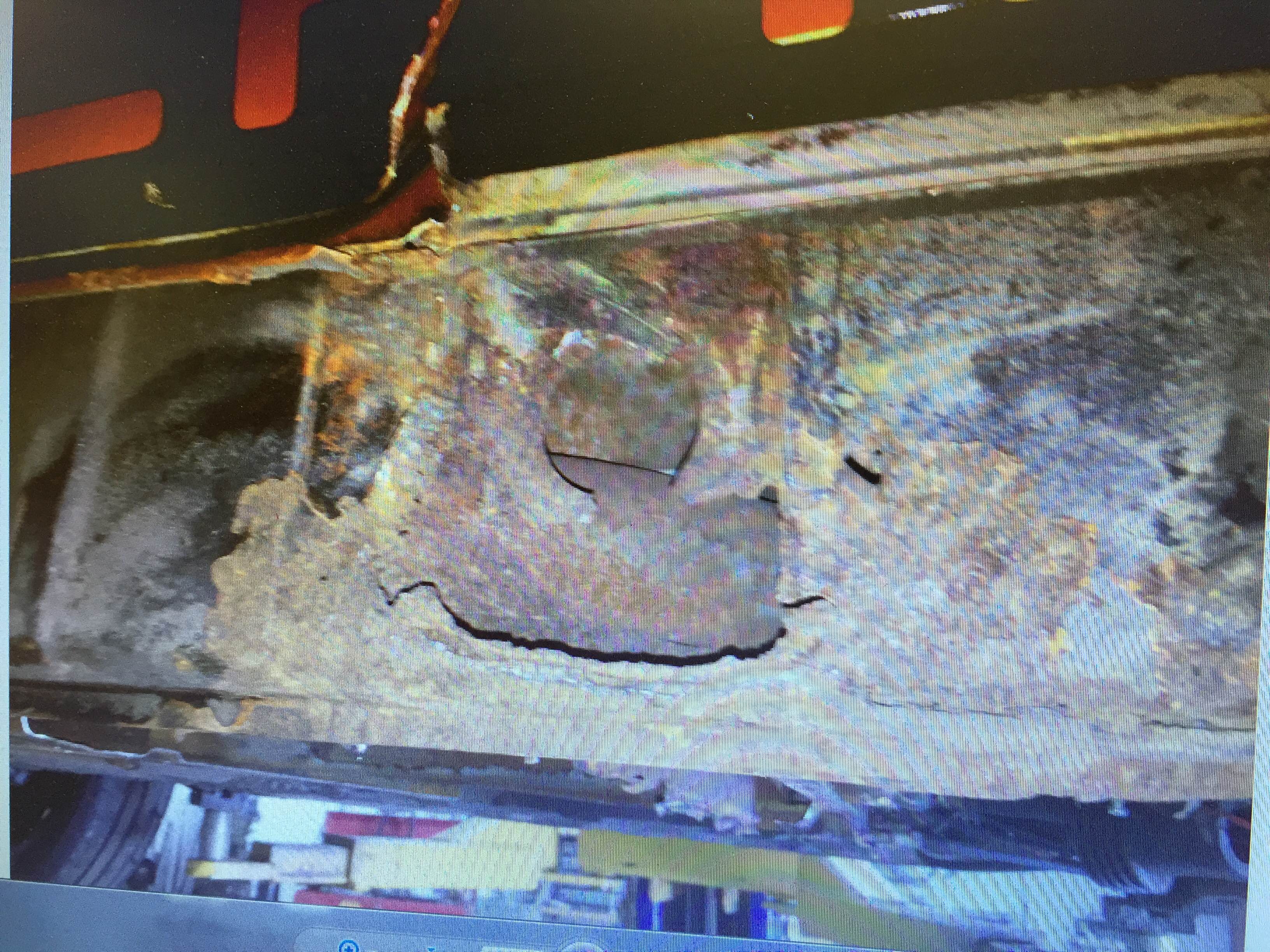

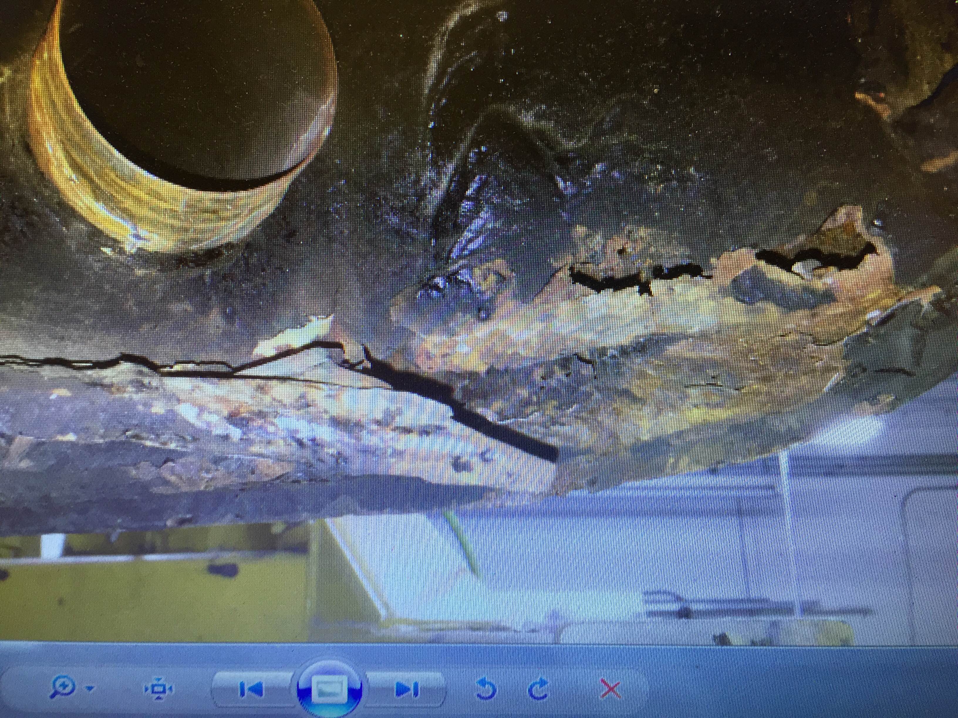

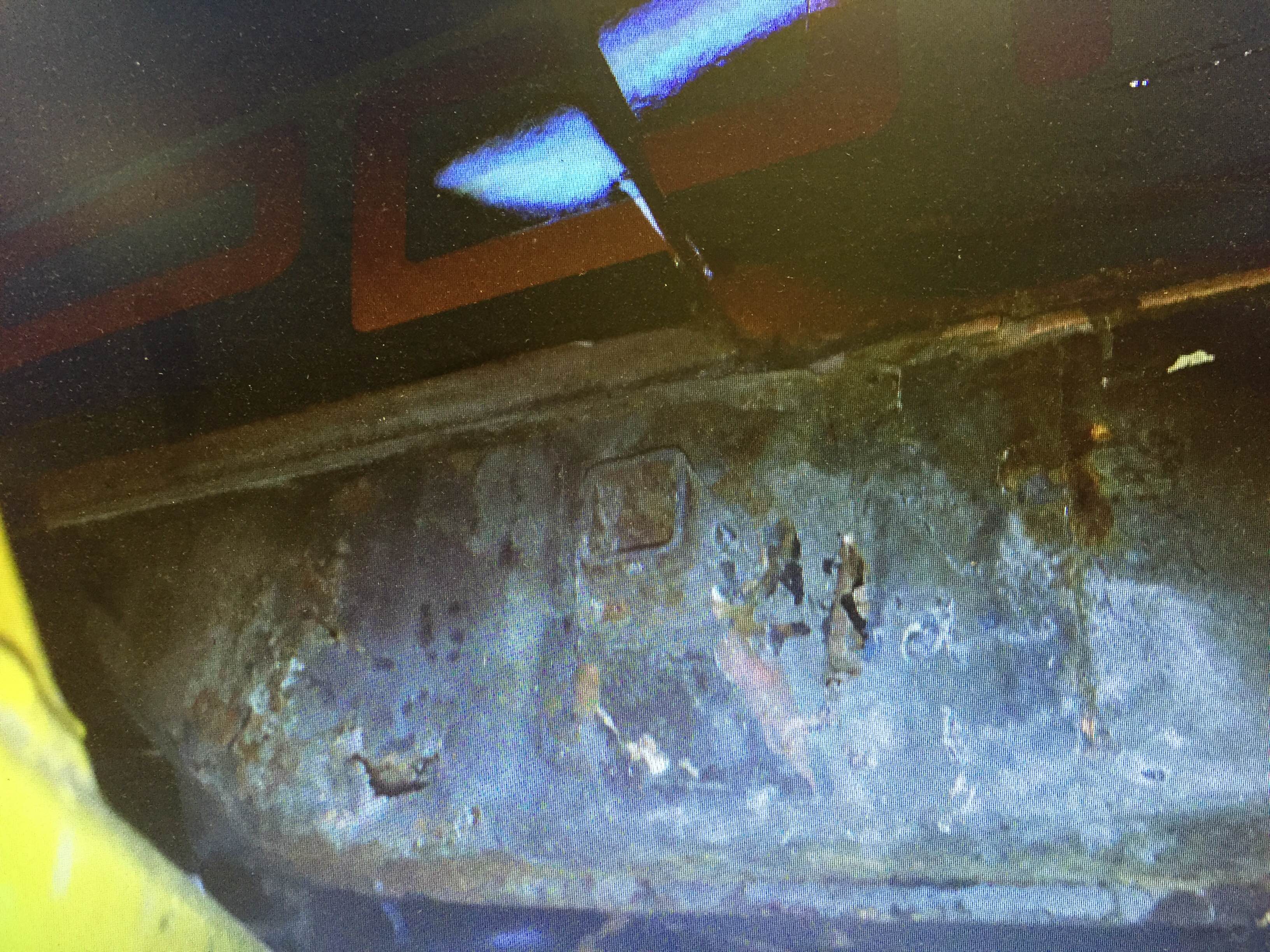

rusty long on passenger side
and drivers side

Philip W.   rusty long on passenger side and drivers side   Mar 19 2018, 12:09 PM
Philip W.   removal process began - drivers side half floor pa...   Mar 19 2018, 12:11 PM
Philip W.   fender lip repair, then worked some by Ed to get m...   Mar 19 2018, 12:14 PM
Philip W.   a few more pictures of the long and jack points re...   Mar 19 2018, 12:17 PM
Philip W.   will get more off the phone later, - back to work...   Mar 19 2018, 12:18 PM
