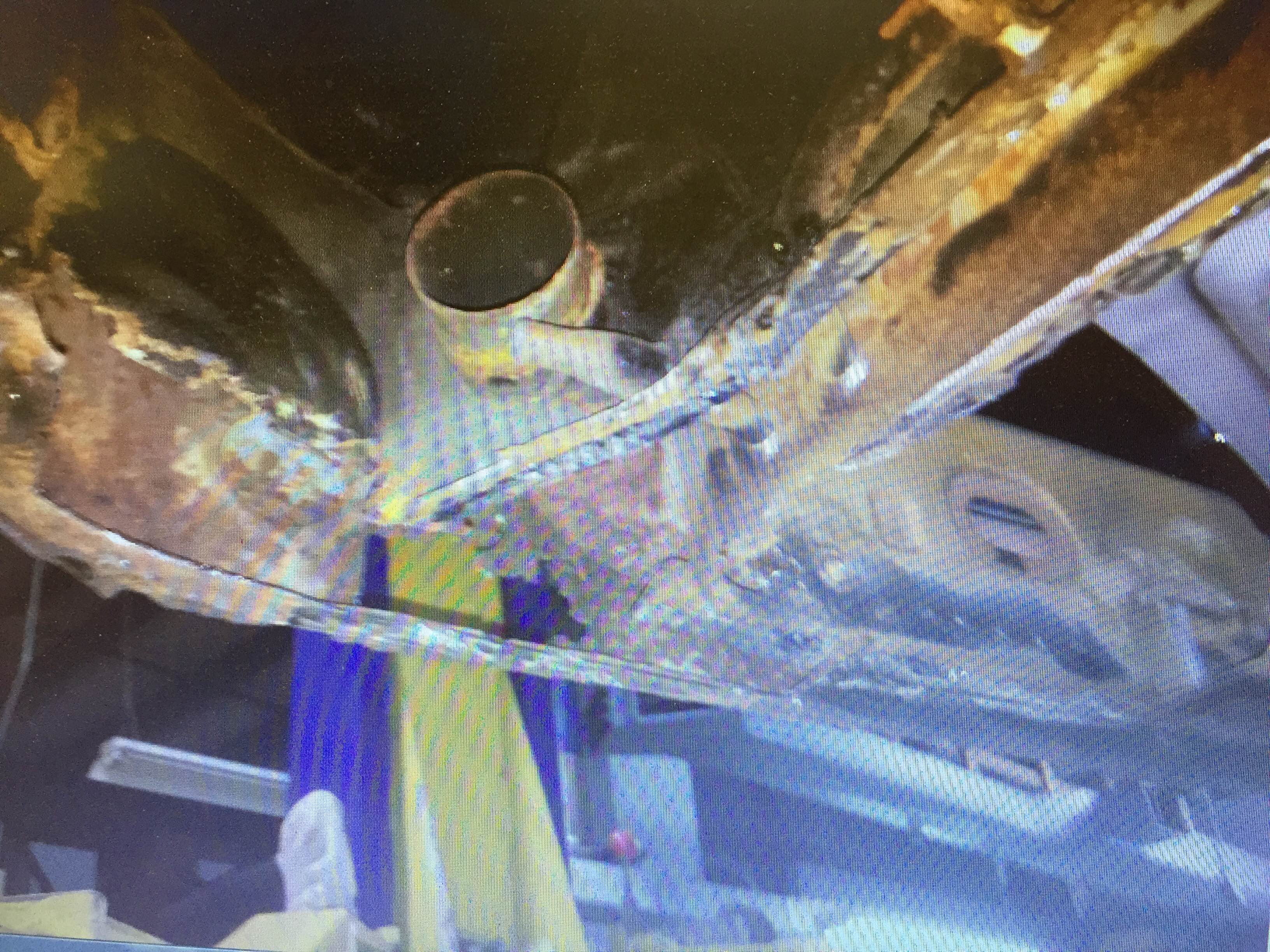

removal process began - drivers side half floor pan out, jack points removed long etc.

Philip W.   removal process began - drivers side half floor pa...   Mar 19 2018, 12:11 PM
