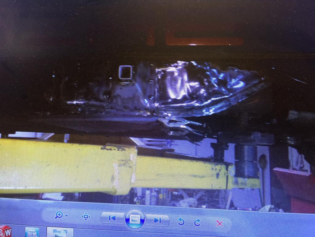

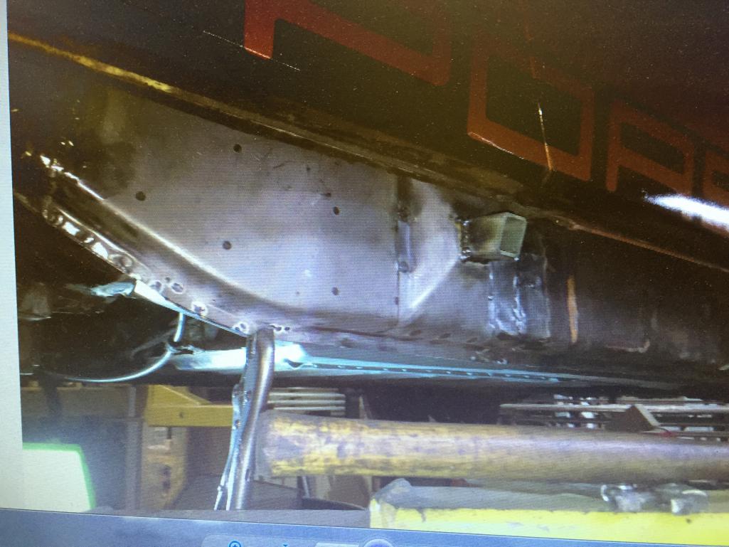

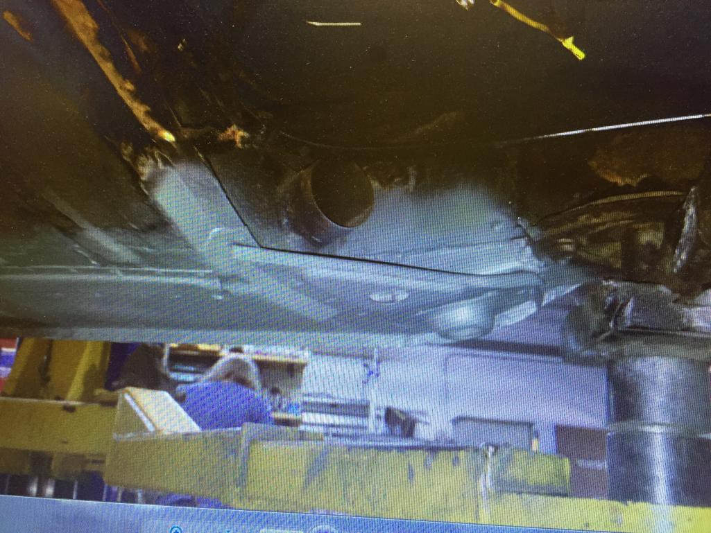

a few more pictures of the long and jack points replacement - someday I will get Chris Foley to forward me better pictures if he has them, this is what I took with my phone camera off the computer screen.

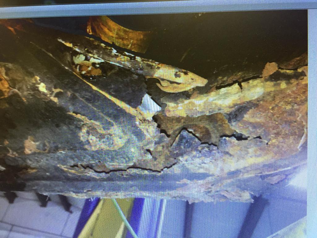

Philip W.   these 2 pictures you can see the bend or crease of...   Mar 19 2018, 12:07 PM
Philip W.   rusty long on passenger side and drivers side   Mar 19 2018, 12:09 PM
Philip W.   removal process began - drivers side half floor pa...   Mar 19 2018, 12:11 PM

Philip W.   a few more pictures of the long and jack points re...   Mar 19 2018, 12:17 PM
