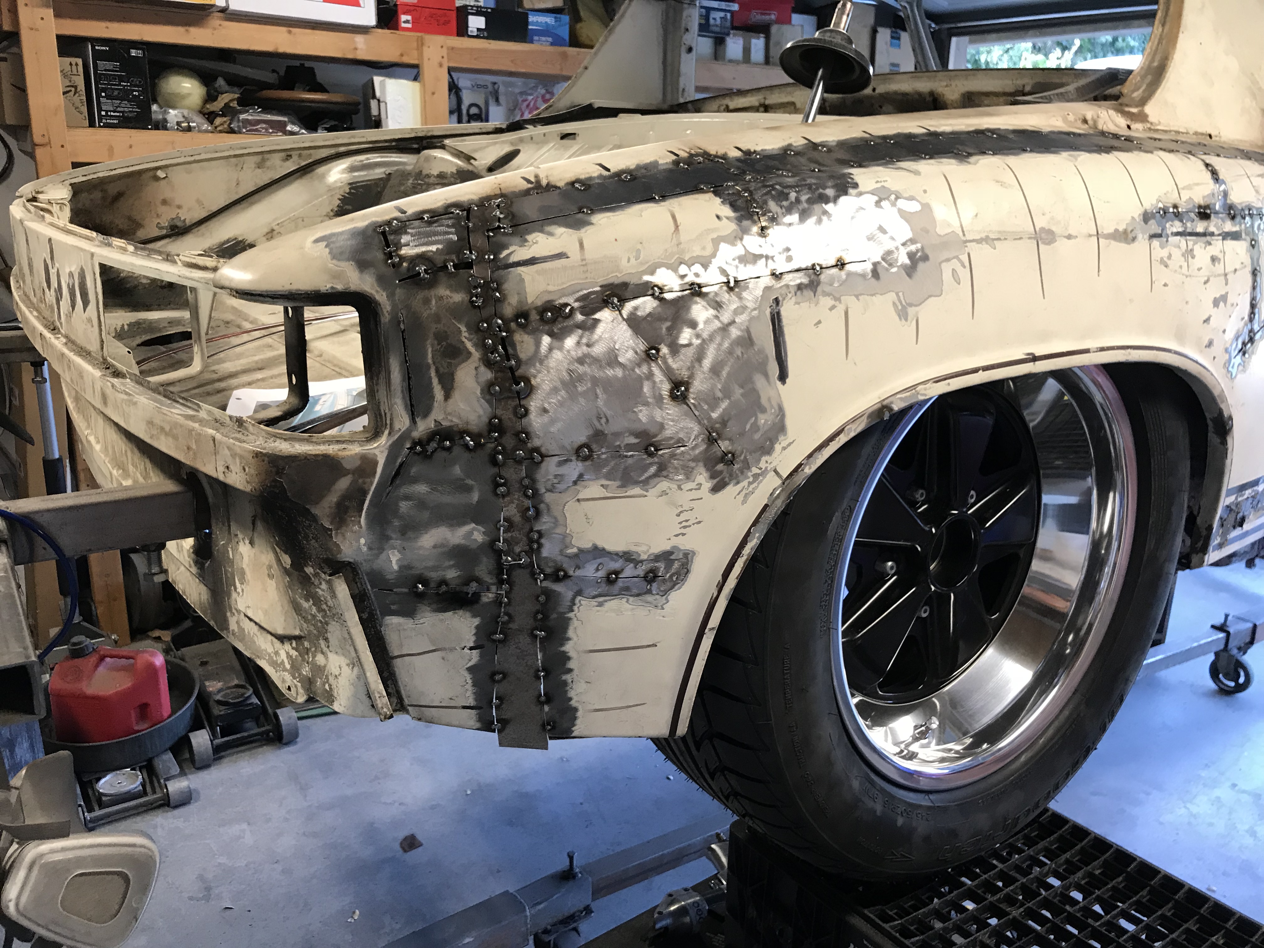

And so it begins.
I am starting to bring back a 75 that was sitting in a field since around 92. A little damage on the passenger side that only took a short time to rough out.
I modified a couple of old engine stands so I could fully rotate the car.
Most of the damage is the floor and back firewall from a loose rear window. I have not found any rust in the longs, YET.
I just finished a 4 year project restoring a 59 Karmann Ghia. It was my first restoration.
I have not decided where to go with this car yet. I originally wanted to recreate the last 914 I had in the early 90s but we will see where it goes.Attached Image

djway   Well, I have made a lil progress since my last pos...   Apr 4 2018, 12:58 AM
djway   Strut placement   Apr 4 2018, 01:02 AM
djway   working on some brake boost for olden years   Apr 4 2018, 01:03 AM
djway   Battery out of the way   Apr 4 2018, 01:04 AM
djway   Por 15 in all rust prone areas all over the car   Apr 4 2018, 01:05 AM
djway   It got very Flintstones for a while   Apr 4 2018, 01:07 AM
djway   Moved the fenders out a lil   Apr 4 2018, 01:11 AM
Philip W.   Moved the fenders out a lil See now that is what...   Apr 4 2018, 06:49 AM
djway   Front fenders out   Apr 4 2018, 01:13 AM
mepstein   Wow, nice job on the flares. If we (east coast) l...   Apr 4 2018, 05:05 AM
billh1963   Wow! You must like to weld :headbanger:   Apr 4 2018, 05:05 AM
ValcoOscar   From the looks of it and seeing pics of your first...   Apr 4 2018, 07:04 AM
Edward Blume   Nice! Putting your skills to work! :headb...   Apr 4 2018, 07:13 AM
Cairo94507   Those flares are looking great. If I had another ...   Apr 4 2018, 07:14 AM
jd74914   Those flares are awesome!! I did something...   Apr 4 2018, 10:09 AM
djway   Those flares are awesome!! I did somethin...   Apr 5 2018, 12:19 PM
djway   I have been asked to provide more picts of the pro...   Apr 4 2018, 10:44 PM
djway   more   Apr 4 2018, 10:46 PM
djway   Front   Apr 4 2018, 10:50 PM
