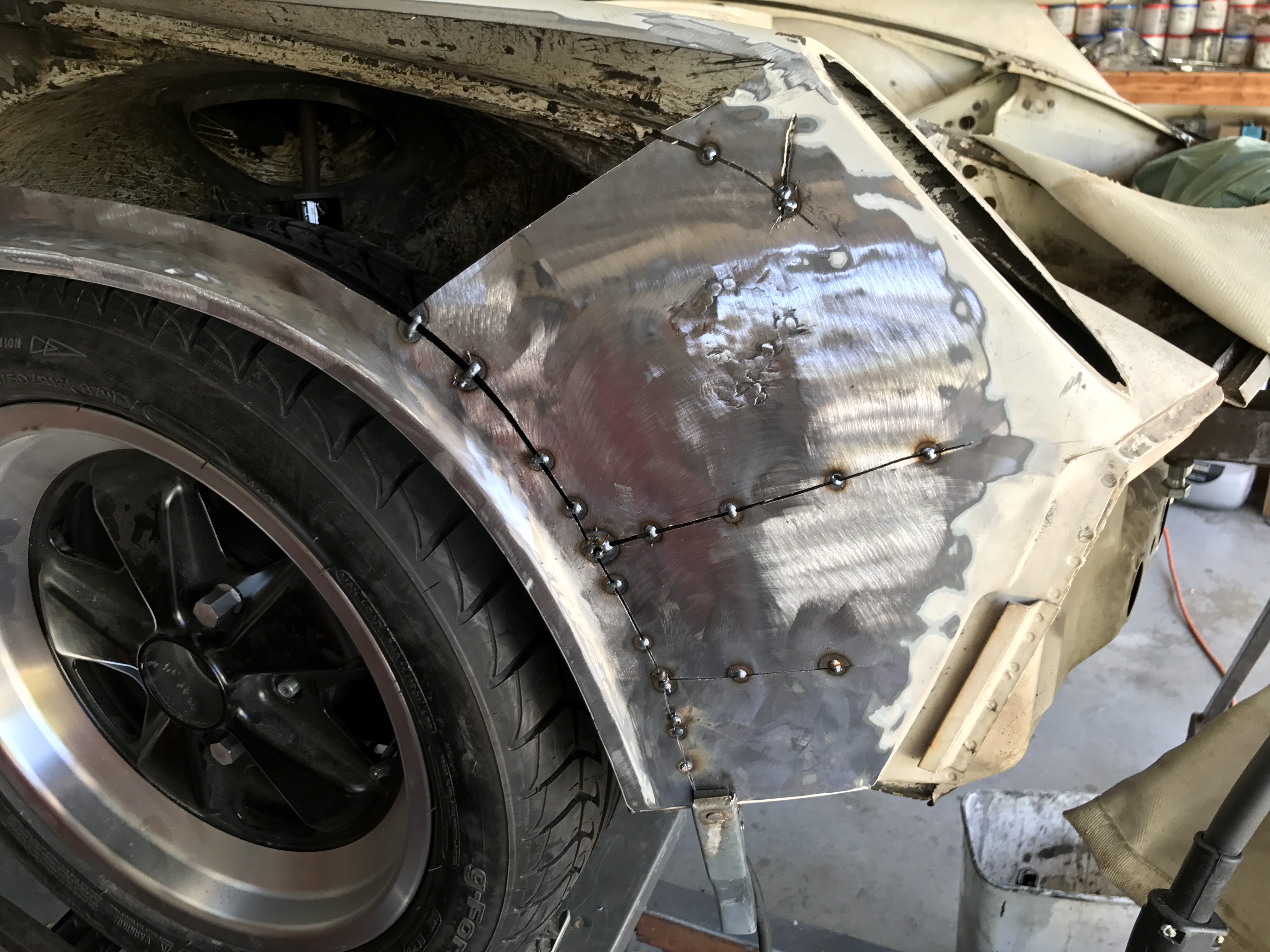

djway   Well, I have made a lil progress since my last pos...   Apr 4 2018, 12:58 AM

djway   Moved the fenders out a lil   Apr 4 2018, 01:11 AM
Philip W.   Moved the fenders out a lil See now that is what...   Apr 4 2018, 06:49 AM
djway   Front fenders out   Apr 4 2018, 01:13 AM
mepstein   Wow, nice job on the flares. If we (east coast) l...   Apr 4 2018, 05:05 AM
billh1963   Wow! You must like to weld :headbanger:   Apr 4 2018, 05:05 AM
ValcoOscar   From the looks of it and seeing pics of your first...   Apr 4 2018, 07:04 AM
Edward Blume   Nice! Putting your skills to work! :headb...   Apr 4 2018, 07:13 AM
Cairo94507   Those flares are looking great. If I had another ...   Apr 4 2018, 07:14 AM
jd74914   Those flares are awesome!! I did something...   Apr 4 2018, 10:09 AM
