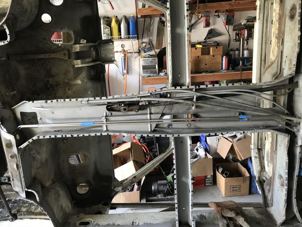

If you want to know what the inside of the tunnel looks like.
I had to weld several breaks in the clutch tube mounts and I added some extra braces for safe measure.
