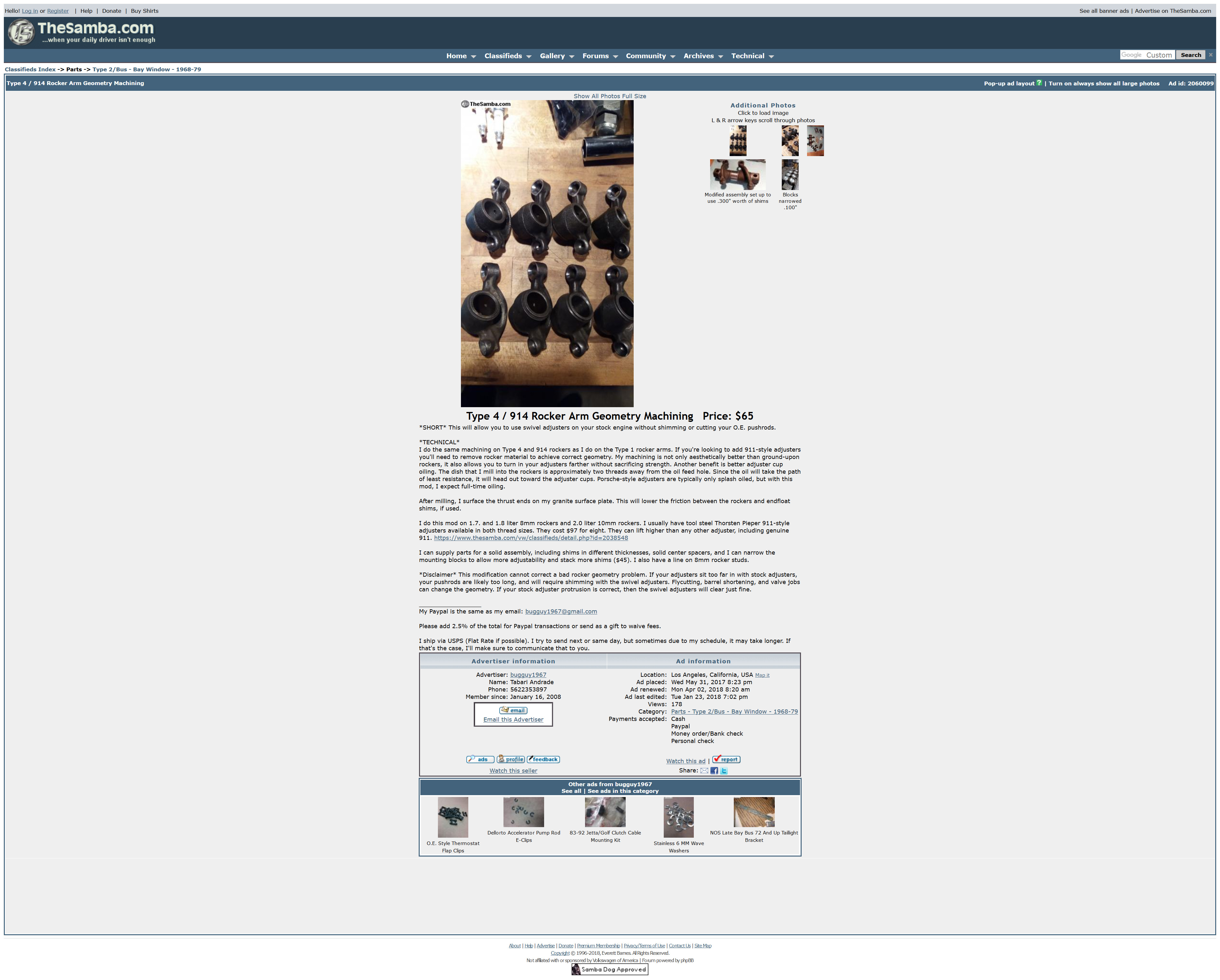

Here you go. This guy can answer all your questions. He did my rockers and stands. He sold me the German 10mm swivel foot adjusters that will work with a stock cam and stock pushrods. Email: bugguy1967@gmail.com. He has ads on theSamba.

MarkV   https://www.thesamba.com/vw/classifieds/det....php...   Apr 6 2018, 09:07 PM
