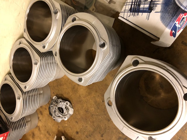

jfort   Jugs are back from Wisconsin with new nikisol. (Si...   Apr 8 2018, 03:56 PM

jfort   re-nikasiled jugs to achieve correct tolerance   May 15 2018, 11:46 AM
