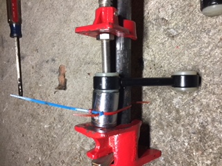

Next question.........I need to install the drop link cup bushings for the rear sway bar. I haven't a clue as to the correct way to accomplish the task. The sway bar is currently in the car, I just got the cup bushings yesterday. They look to be a nylon material.
Would ya'all be so kind as give me some direction. I'm sure it must be simple but keep in mind..........I ain't that smart. Best, mike |

Just to add a bit. While very crude this is an extremely easy way to get the bushings on to the drop links. 23mm socket and. M10 bolt.
Bushing is tough enough to push directly on. Took 5 min to do all 4. ![]() |
