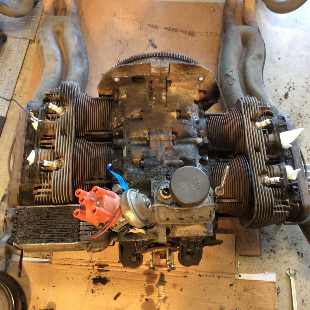

Ok. This is hopefully as far as I will go.
Having trouble confirming the source of all the oil on top as it is literally everywhere. Possibly coming from loose vacuum connections?
Leak on the bottom is from my arch nemesis the taco plate. Pushrod tubes seem to be holding their own.
Looking for thoughts on how best to clean all the crap off and out of the fins??
Can the oil cooler be cleaned or is it a lost cause?
Thanks.

GeorgeRud   I think you got your money’s worth out of those ...   Apr 21 2018, 10:18 PM
porschetub   That's messy,don't often see a disk do tha...   Apr 22 2018, 02:04 AM
Porschef   Throw in some SS fuel lines while the engine's...   Apr 22 2018, 06:23 AM

98101   Going to do my clutch (pushrod tube seals, rear ma...   Apr 22 2018, 01:42 PM

rgalla9146   Ok. This is hopefully as far as I will go. ...   Apr 22 2018, 05:30 PM

Perry Kiehl   You are going to run much cooler with all the moto...   Apr 22 2018, 07:16 PM

porschetub   A good clean on the housing you will be good,if yo...   May 5 2018, 11:56 PM
Amphicar770   Fun stuff. Did mine about a year ago. There are...   May 6 2018, 09:30 AM
Amphicar770   Regarding oil cooler. They are not expensive. I go...   May 6 2018, 09:53 AM
loco914   Regarding oil cooler. They are not expensive. I g...   May 7 2018, 12:45 PM
loco914   Slow, but making progress. Estimating the equivale...   May 12 2018, 01:11 PM
cuddy_k   Steam cleaner. Under 100 bucks at HF. https://ww...   May 12 2018, 02:08 PM
1adam12   I just finished cleaning my engine up. Took about...   May 12 2018, 03:02 PM
