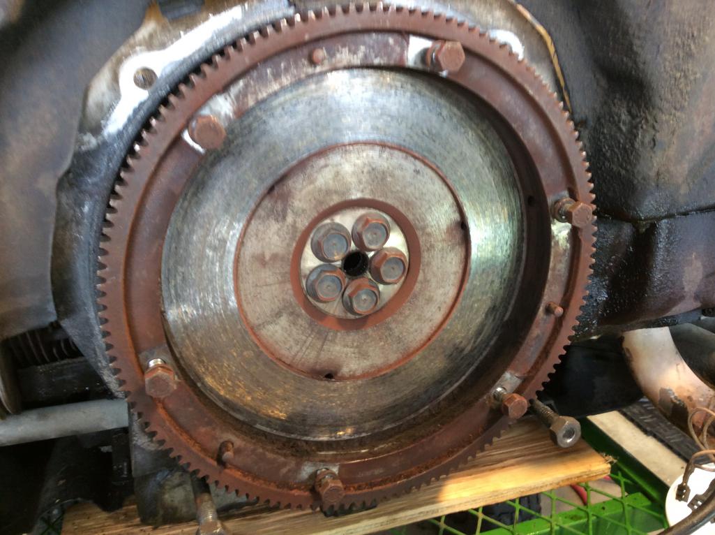

loco914
post Apr 22 2018, 12:12 PM
Thy wheels have left the rail...
Posts: 47
Joined: 1-April 10
From: Amarillo, TX
Member No.: 11,542
Here’s the flywheel. Plan to remove and have it checked out.
Other progress today:
Learning that engine tin screws can be quite stubborn (IMG:style_emoticons/default/headbang.gif)
porschetub
post Apr 22 2018, 06:00 PM
Posts: 5,168
Joined: 25-July 15
From: New Zealand
Member No.: 18,995
QUOTE(loco914 @ Apr 23 2018, 06:12 AM) *
Ok flywheel appears ok,any ridges you can feel on the surface with your fingernail generally means it will need to be refaced if still in spec.
You can hit on the top the engine tin screws with a hammer and punch then use an impact tool on them ,if the slots are chewed out use some visegrips on them as a final solution.
To clean the long block completely seal off the inlet/exhaust ports ,etc,buy lots of decreaser and brush it on with a wash brush,let it soak it then hose or waterblast off.
If it was my engine I would take the cooler off after you have cleaned the block and have it ultrasonically cleaned,they get really dirty inside also.
Do all seals on the engine "while in there" you will thank yourself later (IMG:style_emoticons/default/beer.gif) .

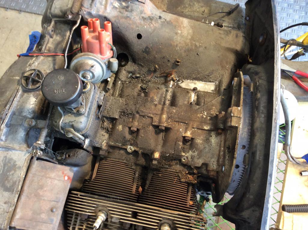

loco914   Ok. This is hopefully as far as I will go. ...   Apr 22 2018, 05:04 PM
rgalla9146   Ok. This is hopefully as far as I will go. ...   Apr 22 2018, 05:30 PM

loco914   A little progress last night and today. Got the mu...   May 5 2018, 06:55 PM
porschetub   A good clean on the housing you will be good,if yo...   May 5 2018, 11:56 PM
