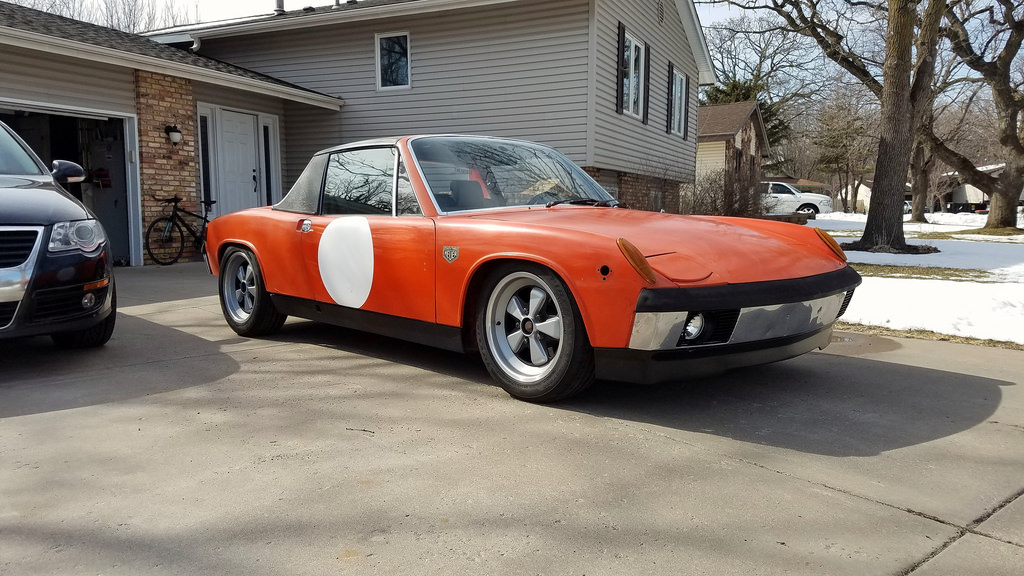

Anyway, the result is good. It's running and driving, the 1911 is strong and runs well. Handles great considering there are no sway bars. Tail shifter is as vague as you imagine though, and the engine is still sub 100hp so it's not incredibly fast.
(IMG:http://www.914world.com/bbs2/uploads_offsite/c1.staticflickr.com-19709-1496565572.1.jpg)
It's first real public appearance was at the June C&C that I attended with a good friend in his 911.

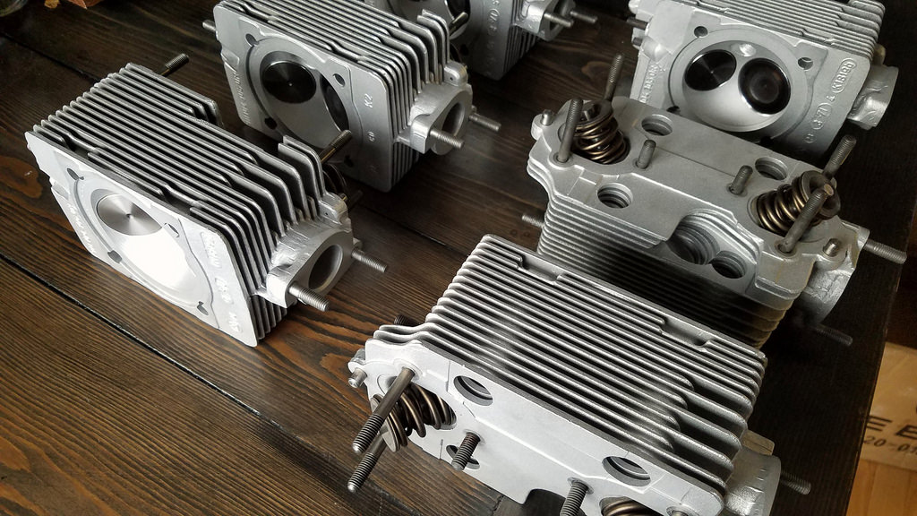

I got my heads back from the shop, seats were virgin so that was nice. New valves, guides, seals. Springs were low mileage units I had found else ware, all were checked and were within spec. He had one exhaust stud that he had to drill/replace.
I love new parts.
(IMG:http://www.914world.com/bbs2/uploads_offsite/c1.staticflickr.com-19709-1524666330.1.jpg)
So now is where I am supposed to start saving for the case work, except I already had a few other things in the pipeline for the 914 so I'm finishing these off.

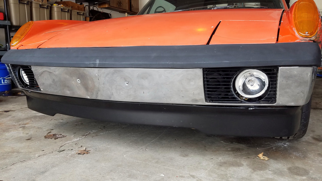

First things first, the front end needed a bit of an uplift. I liked the LE style front valence, and the non-foglight grills I had were warped badly. I found a page detailing the use of modern driving lights in place of the OE fog lights. It was good on my wallet so I went through with it.
Fit and finish isn't the best, but acceptable for a driver. Light output will be far greater than what I had. They are driving lights, so much brighter than fog lights. I will be aiming them so that they don't blind people.
LE replica valence is of great quality. I had to drill the mounting holes of course but it all lined up pretty well. Quick shot of satin black to tie it all in.
(IMG:http://www.914world.com/bbs2/uploads_offsite/c1.staticflickr.com-19709-1524666330.2.jpg)
(IMG:http://www.914world.com/bbs2/uploads_offsite/c1.staticflickr.com-19709-1524666330.3.jpg)

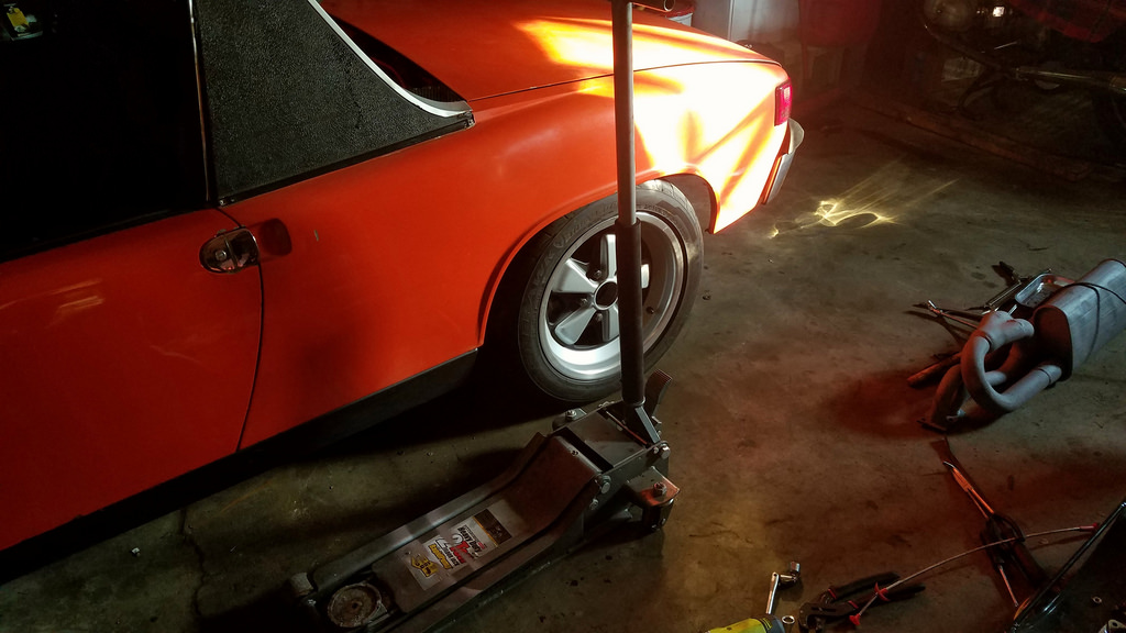

Next on the list is the side-shift trans swap. Rudedude set me up with just about all of the parts I needed. Ordered a couple soft parts since I was going to be in there anyway and I needed the conversion bushing. I got it all stripped down and was ready to start reassembly and that's when I discovered that the new conversion bushing I had ordered was the wrong part. I looked online where I ordered it and sure enough it's listed as a part for an early-late transmission conversion. Turns out it's just a stock replacement for an early car... so a new one is ordered and should be here this week.
The trans and bar are in at least. I'll be rebuilding the axles with new boots and grease, and might try to do something about my muffler.
(IMG:http://www.914world.com/bbs2/uploads_offsite/c1.staticflickr.com-19709-1524666330.4.jpg)
All in all, R&R of the transmission with the engine and exhaust still in place was easier than I anticipated. Using just a floor jack. To help line up the drive splines I grabbed both of the axle flanges and turned them back and fourth the same direction while simultaneously pushing the trans to the engine. Snicked right into place on the first try.
This weekend I am going to try and finish the swap and get the car tuned up. Might make it out to a local swap meet for another project of mine... a 2007 VW Passat...
