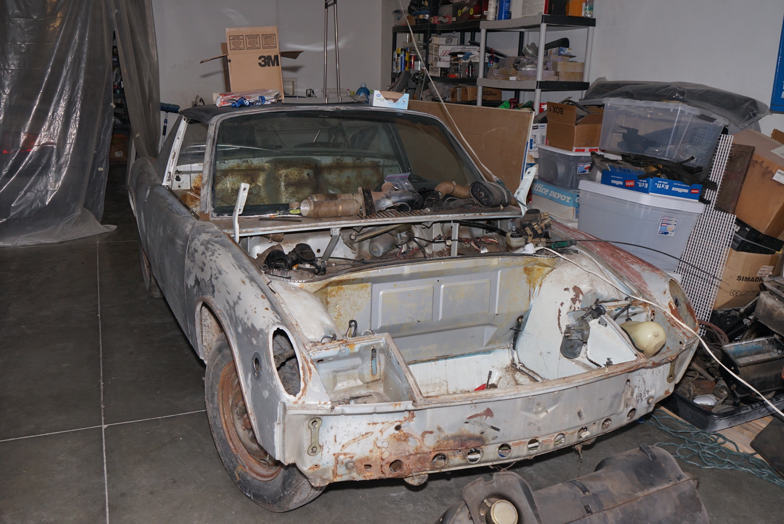

I just bought a 1972 914 from a friend a couple of weeks ago and I am trying to come up with a plan on how to get this car back on the road. It seems it has been off the road for more than 10 years and it has just sat since then. Luckily it had been kept from the elements so there is minimal surface rust and most body panels are straight.
The engine seems to be missing some components and the harness for the fuel injection is in pretty bad shape. Also the engine seems to be from a 1973 model year because the number on it is EB005705 (IMG:style_emoticons/default/sad.gif)
Now since the engine isn't original for the car I do not know if it's worth to go on an all out restoration or to just do a repaint, fix all the mechanicals and get it on the road again, what do you guys think?

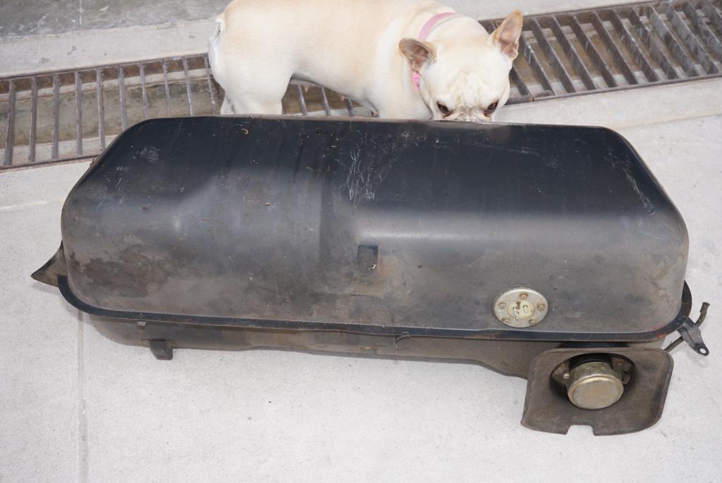

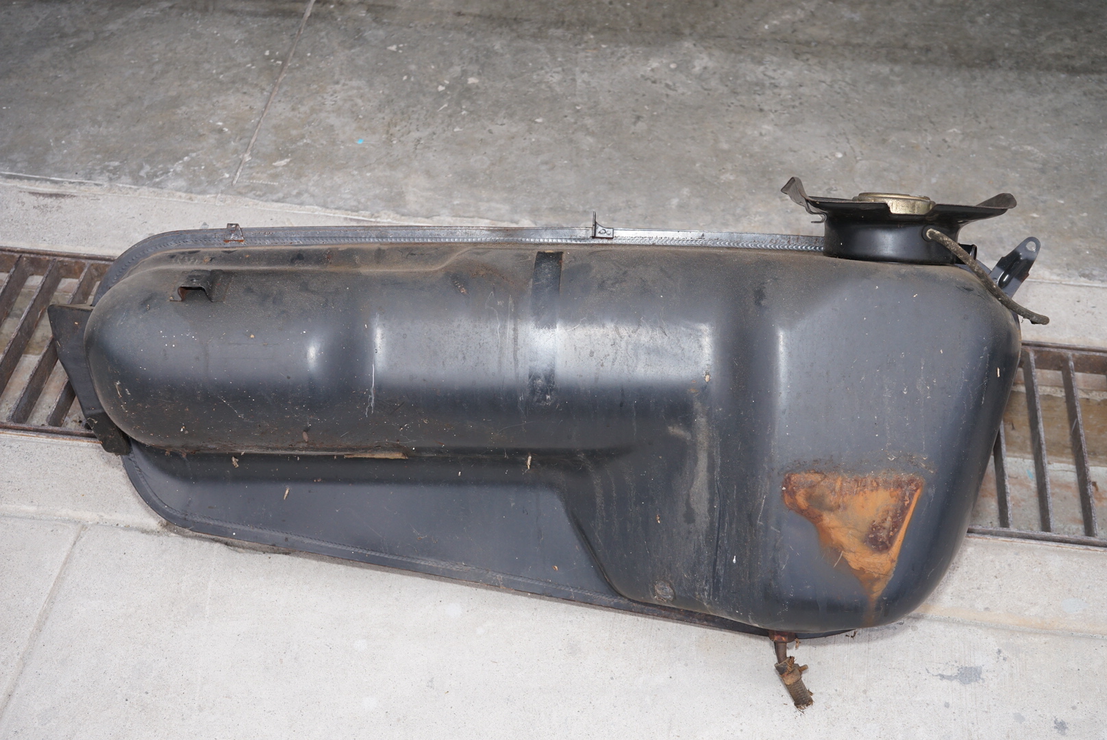

After I got it home I started tearing into it and removed the fuel tank along with other pieces in there. I was surprised that the fuel tank is in such good condition. Even inside it was really nice and clean.
