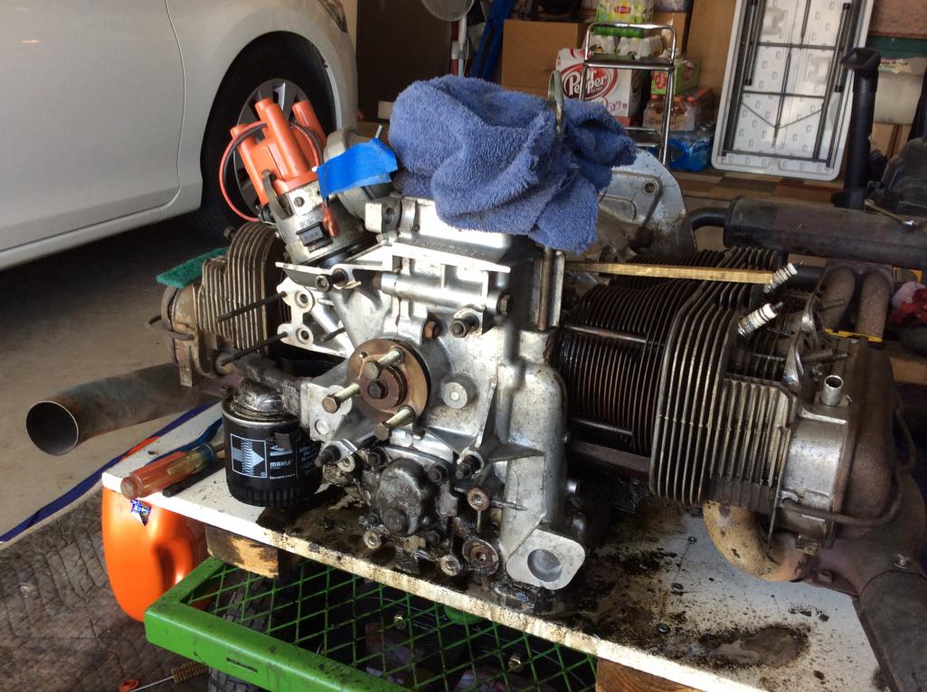

First engine/tranny drop was successful.
Pulled the clutch and found this...
The adventure begins...

Slow, but making progress. Estimating the equivalent of 5 hp gain just from the weight of all the crap coming off (IMG:style_emoticons/default/sunglasses.gif)
Any tips for getting deep it the fpiston an head cooling fins???

GeorgeRud   I think you got your money’s worth out of those ...   Apr 21 2018, 10:18 PM
porschetub   That's messy,don't often see a disk do tha...   Apr 22 2018, 02:04 AM
Porschef   Throw in some SS fuel lines while the engine's...   Apr 22 2018, 06:23 AM

loco914   Just don’t understand why it would run hot.... :...   Apr 22 2018, 12:41 PM
Superhawk996   Just don’t understand why it would run hot.... ...   Apr 12 2020, 02:22 PM

Perry Kiehl   You are going to run much cooler with all the moto...   Apr 22 2018, 07:16 PM
loco914   Thanks for all the tips! Keep them coming. It ...   Apr 22 2018, 09:42 PM
Dr Evil   Don't forget the TOB and to see if you need to...   Apr 23 2018, 09:02 AM

porschetub   A good clean on the housing you will be good,if yo...   May 5 2018, 11:56 PM
Amphicar770   Fun stuff. Did mine about a year ago. There are...   May 6 2018, 09:30 AM
Amphicar770   Regarding oil cooler. They are not expensive. I go...   May 6 2018, 09:53 AM
loco914   Regarding oil cooler. They are not expensive. I g...   May 7 2018, 12:45 PM

cuddy_k   Steam cleaner. Under 100 bucks at HF. https://ww...   May 12 2018, 02:08 PM
1adam12   I just finished cleaning my engine up. Took about...   May 12 2018, 03:02 PM
