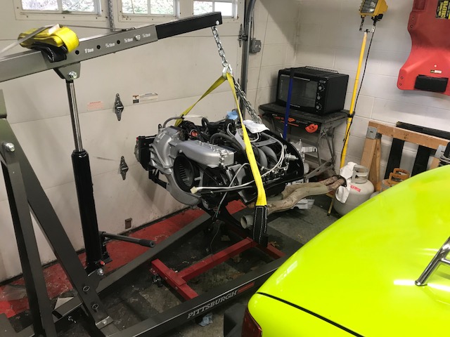

First engine/tranny drop was successful.
Pulled the clutch and found this...
The adventure begins...

GeorgeRud   I think you got your money’s worth out of those ...   Apr 21 2018, 10:18 PM
porschetub   That's messy,don't often see a disk do tha...   Apr 22 2018, 02:04 AM
Porschef   Throw in some SS fuel lines while the engine's...   Apr 22 2018, 06:23 AM
