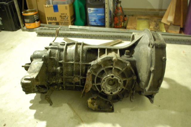

Hello
Is there any way to identify if its an 914/6 gearbox or a regular 914 gearbox?? Which would be the main differences?? Thanks for your help |

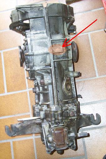

masriallan how to identify if its a 914/6 gearbox? May 14 2018, 10:16 AM
Dr Evil The numbers are located here rather than on the sp... May 14 2018, 10:36 AM
masriallan
The numbers are located here rather than on the s... May 14 2018, 10:44 AM

davep The parts are a bit different. The main casting ma... May 14 2018, 11:01 AM
Dr Evil The boss in the intermediate plate for the throttl... May 14 2018, 12:16 PM
gandalf_025 shift linkage on the end of transmission looks lik... May 14 2018, 01:03 PM
shift linkage on the end of transmission looks li... May 14 2018, 01:27 PM
oldie914 Your transmission was built using the same casting... May 15 2018, 01:55 AM![]() ![]() |
