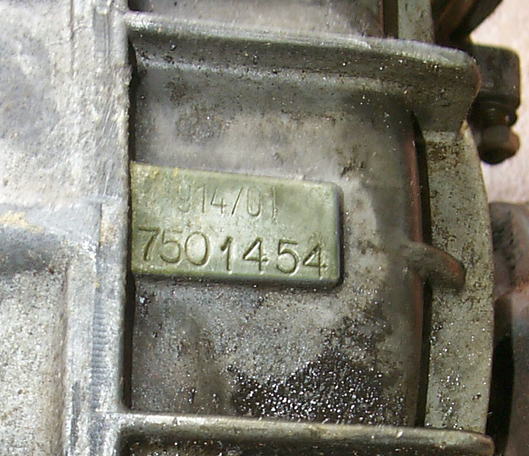

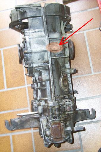

The numbers are located here rather than on the spine.

davep serial number and linkage in the end cap.
Serial #... May 14 2018, 10:20 AM
gms
The numbers are located here rather than on the s... May 14 2018, 05:37 PM
davep The parts are a bit different. The main casting ma... May 14 2018, 11:01 AM
Dr Evil The boss in the intermediate plate for the throttl... May 14 2018, 12:16 PM
gandalf_025 shift linkage on the end of transmission looks lik... May 14 2018, 01:03 PM
shift linkage on the end of transmission looks li... May 14 2018, 01:27 PM
oldie914 Your transmission was built using the same casting... May 15 2018, 01:55 AM![]() ![]() |
