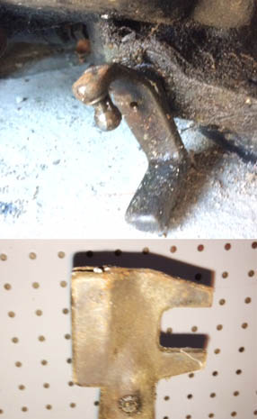

Hello
Is there any way to identify if its an 914/6 gearbox or a regular 914 gearbox?? Which would be the main differences?? Thanks for your help |

shift linkage on the end of transmission looks like the top picture
and the end of the shift rod looks like the bottom picture. Minus dirt and grease of course. ![]() |

davep serial number and linkage in the end cap.
Serial #... May 14 2018, 10:20 AM
Dr Evil The numbers are located here rather than on the sp... May 14 2018, 10:36 AM

davep The parts are a bit different. The main casting ma... May 14 2018, 11:01 AM
Dr Evil The boss in the intermediate plate for the throttl... May 14 2018, 12:16 PM
