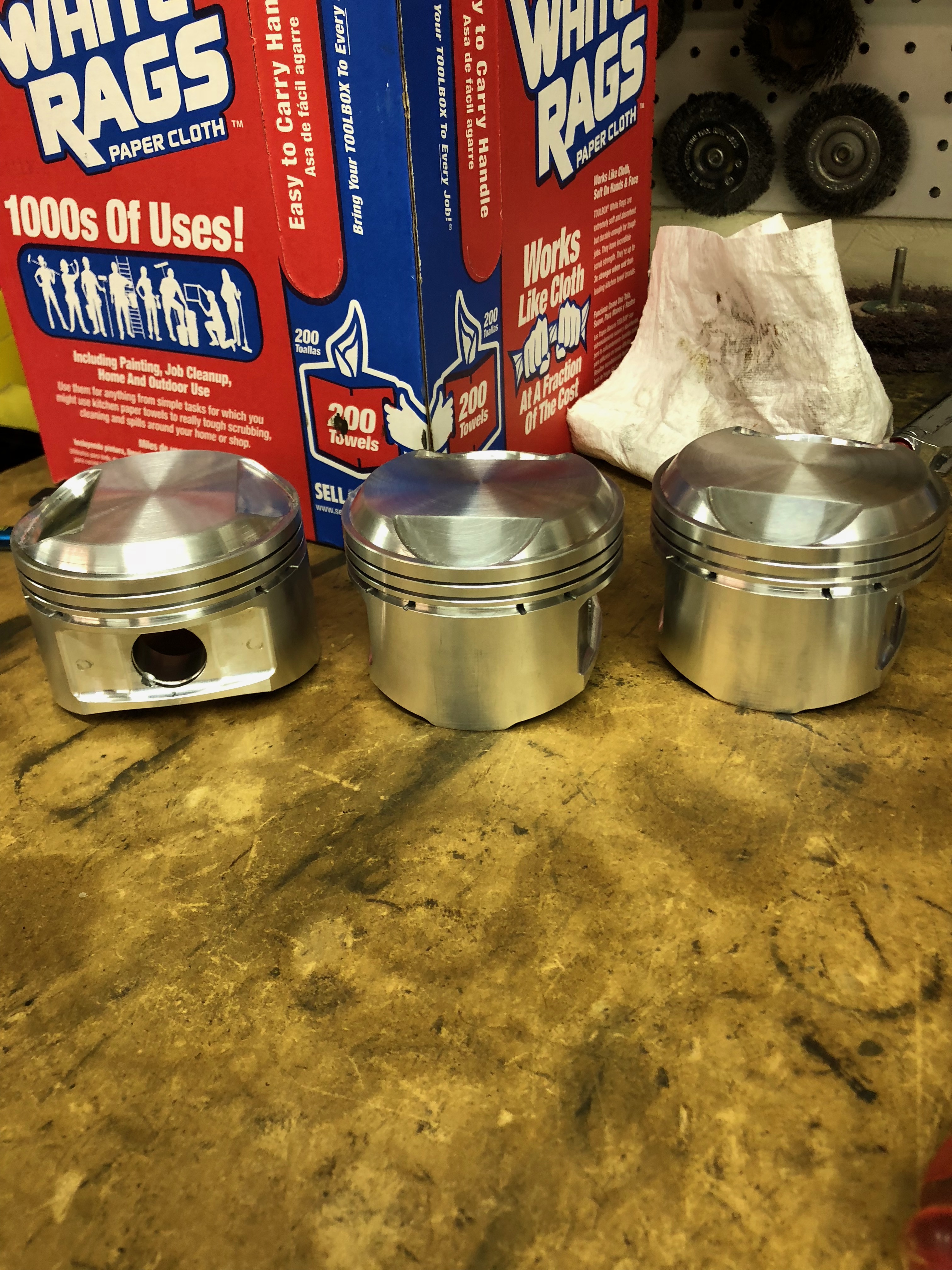

jfort   JE Pistons ready. 10.8:1. had to re-shape bevel to...   May 15 2018, 11:43 AM
