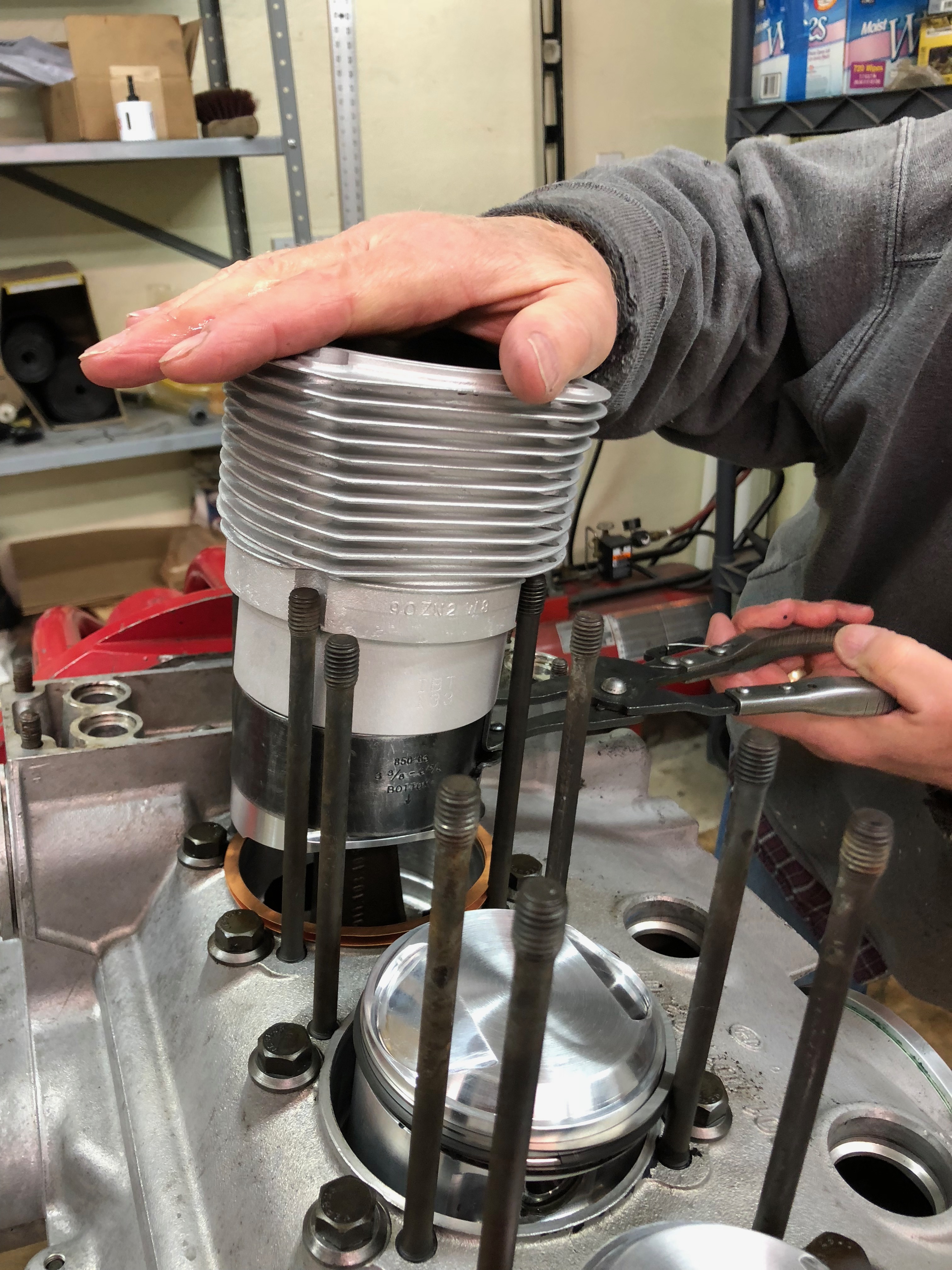

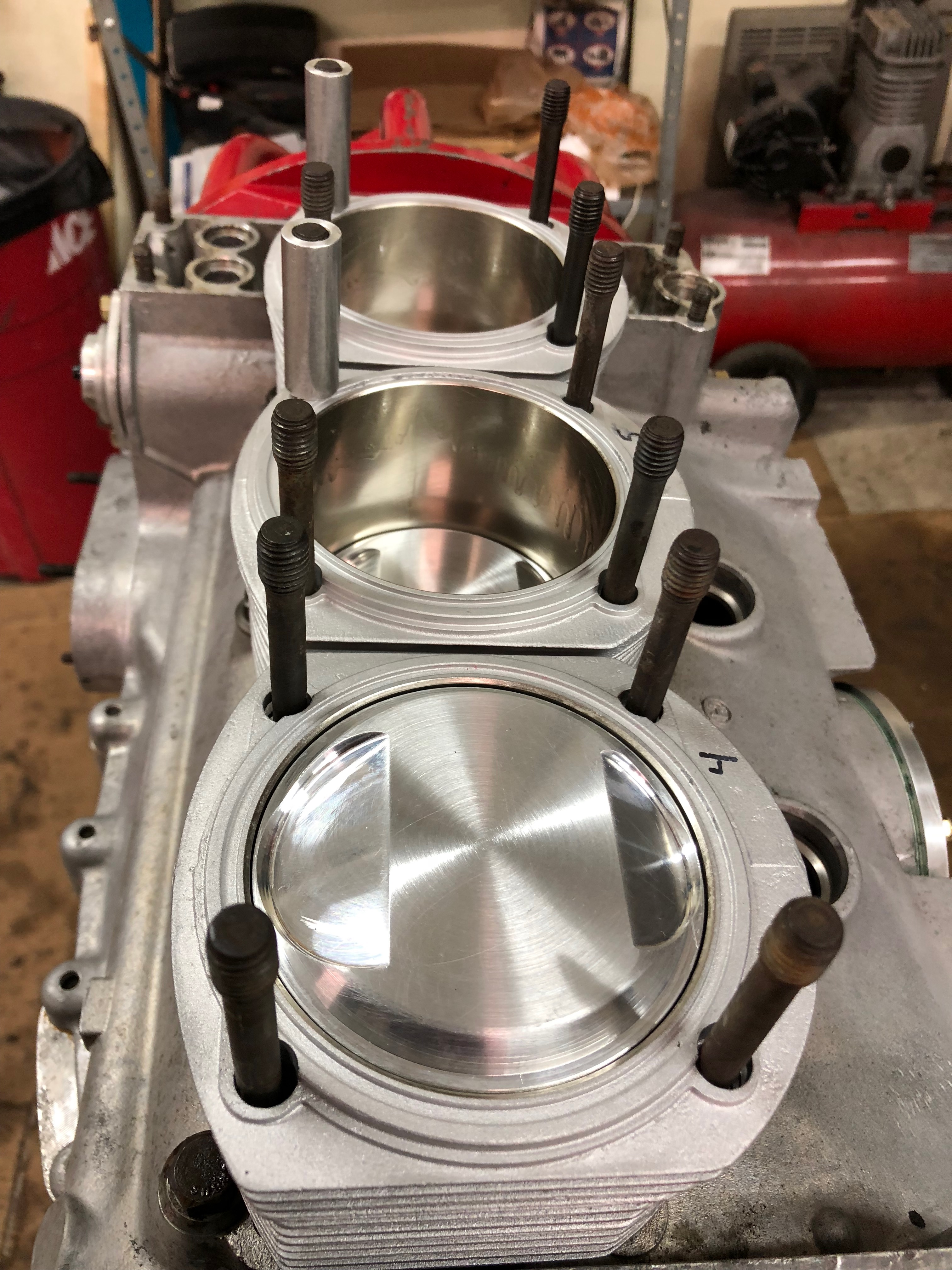

jfort   JE Pistons ready. 10.8:1. had to re-shape bevel to...   May 15 2018, 11:43 AM
jfort   re-nikasiled jugs to achieve correct tolerance   May 15 2018, 11:46 AM
jfort   pistons going in and jugs on   May 15 2018, 11:48 AM

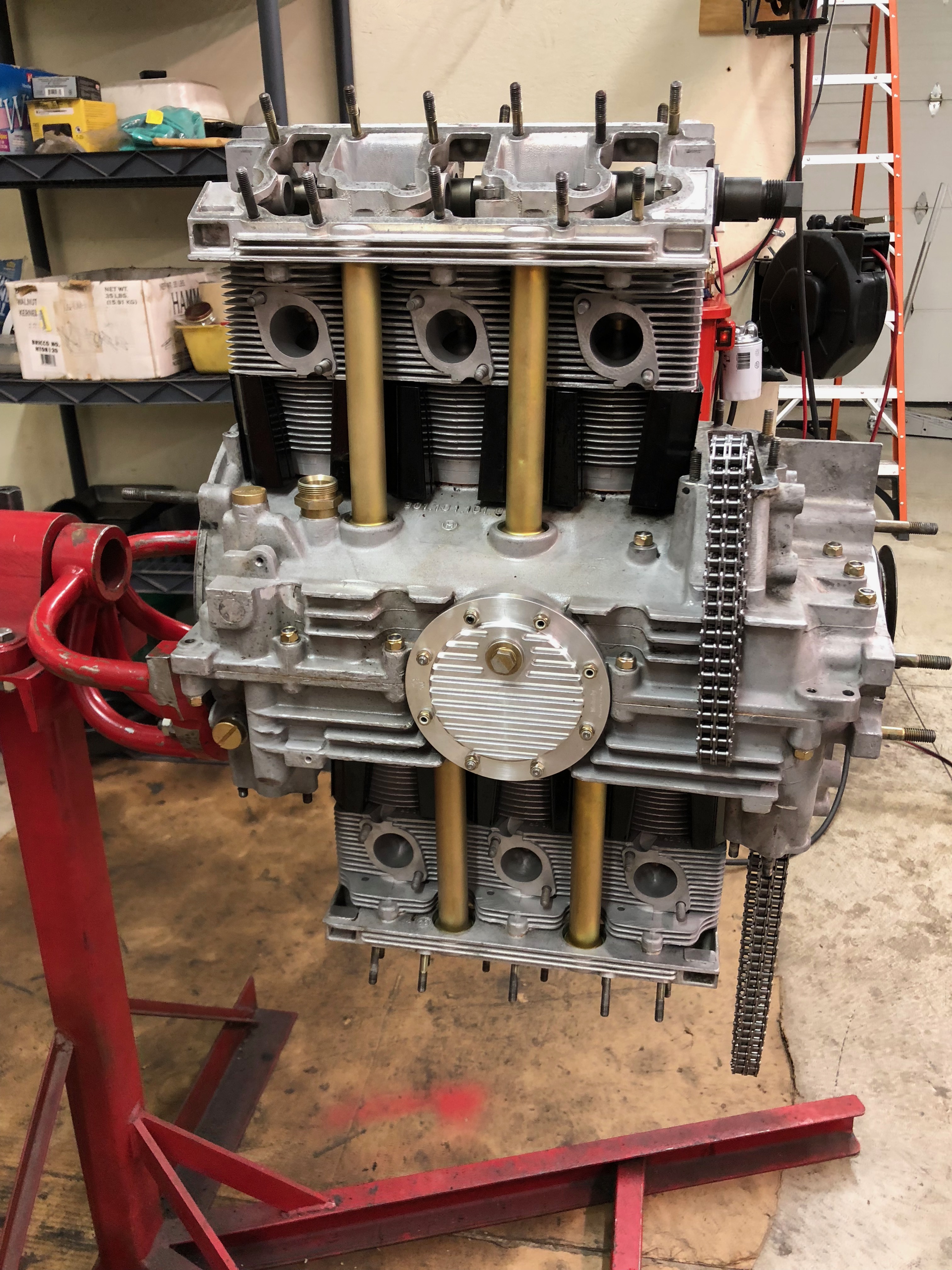

jfort   heads on   May 15 2018, 11:51 AM
jfort   cam housing going on. Loctite 574 doing the sealin...   May 15 2018, 11:53 AM
jfort   RE: Engine Rebuild   May 15 2018, 11:54 AM
jfort   measure depth of and aligning chain sprockets. new...   May 15 2018, 11:56 AM
jfort   the intermediate shaft has a specified "play...   May 15 2018, 12:00 PM
jfort   timing the cams took a lot of time. based on Dough...   May 15 2018, 12:02 PM
jfort   PERFECT!!   May 15 2018, 12:03 PM
jfort   lubed cam lobes, added chain tensioners and covers...   May 15 2018, 12:08 PM

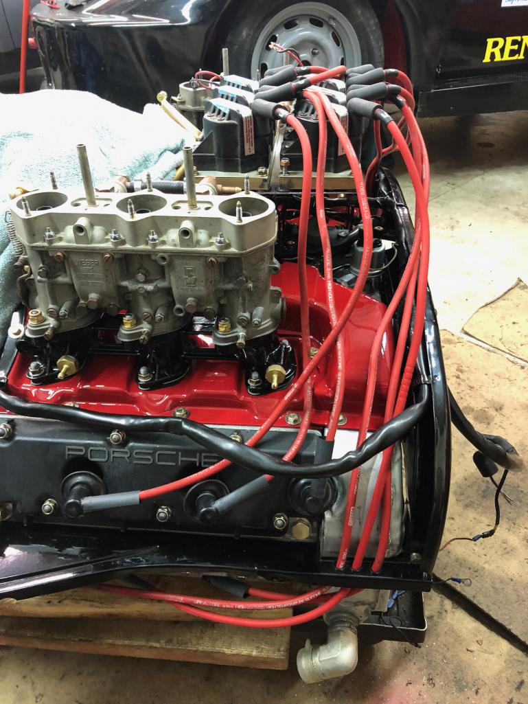

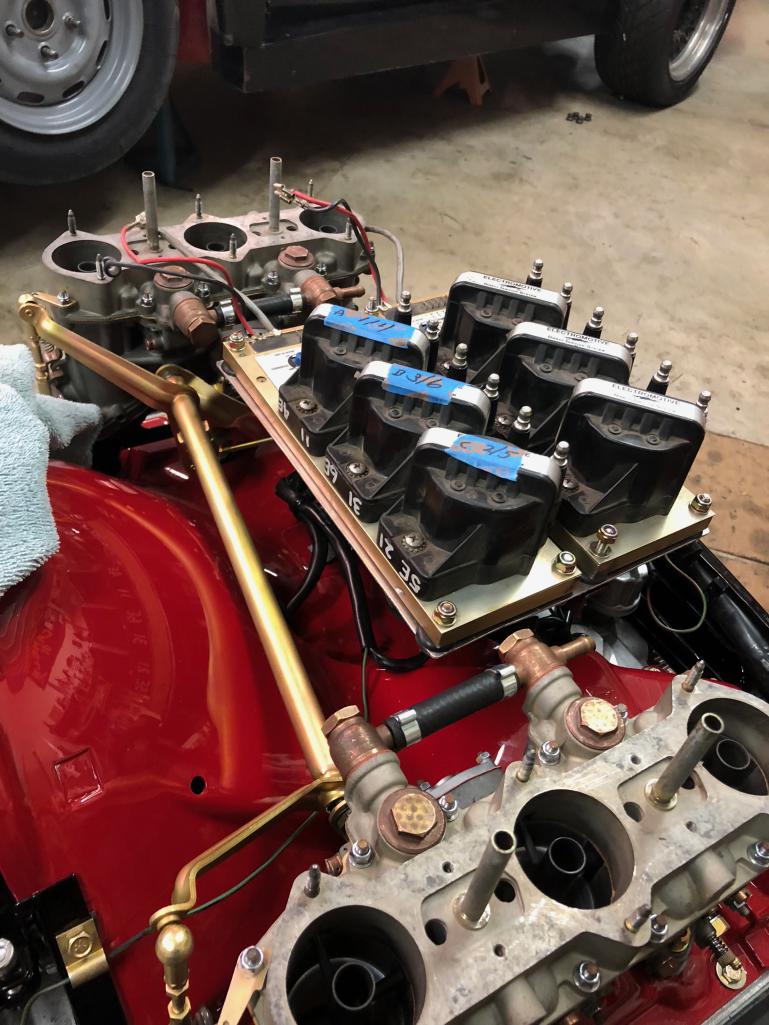

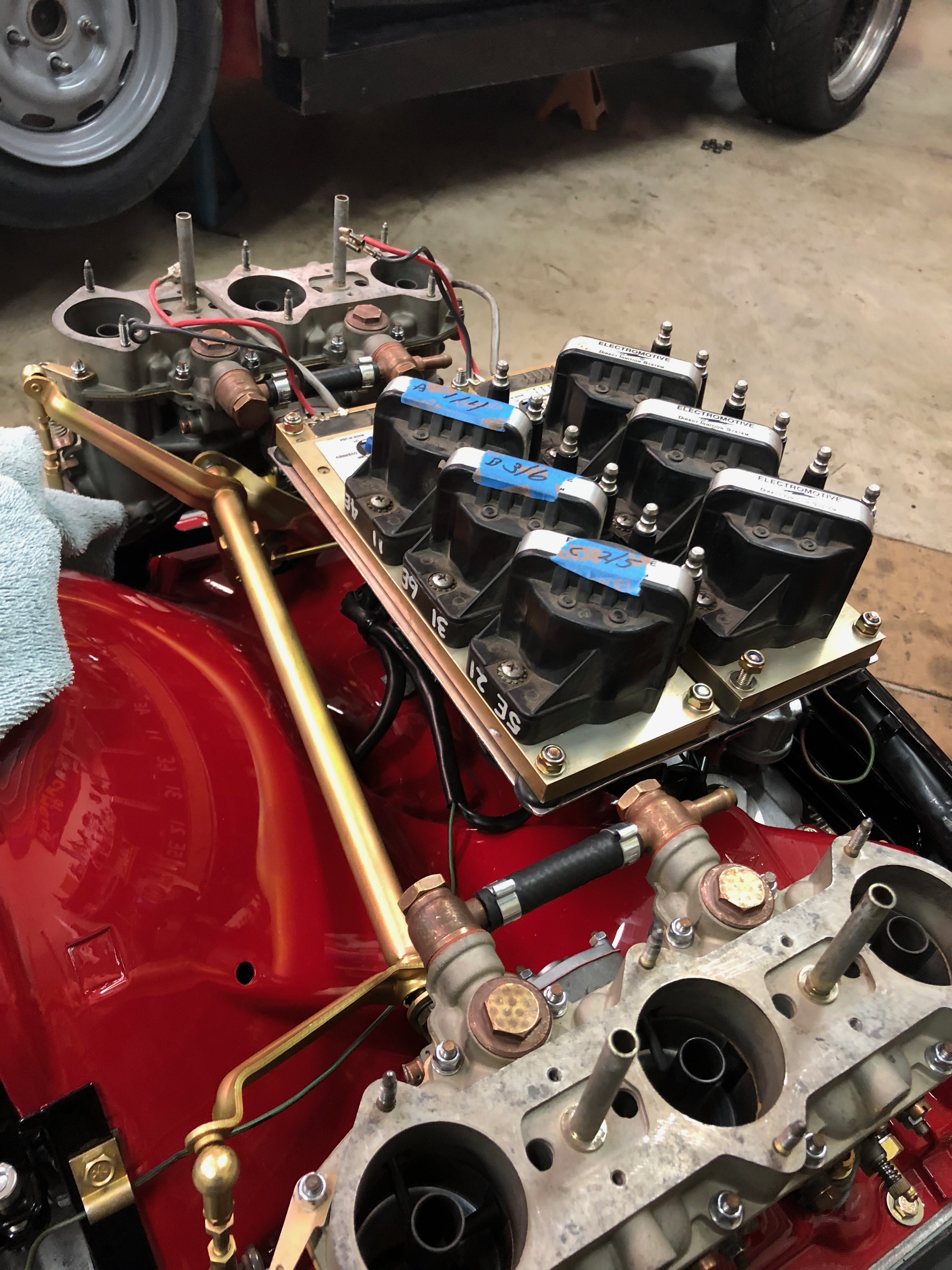

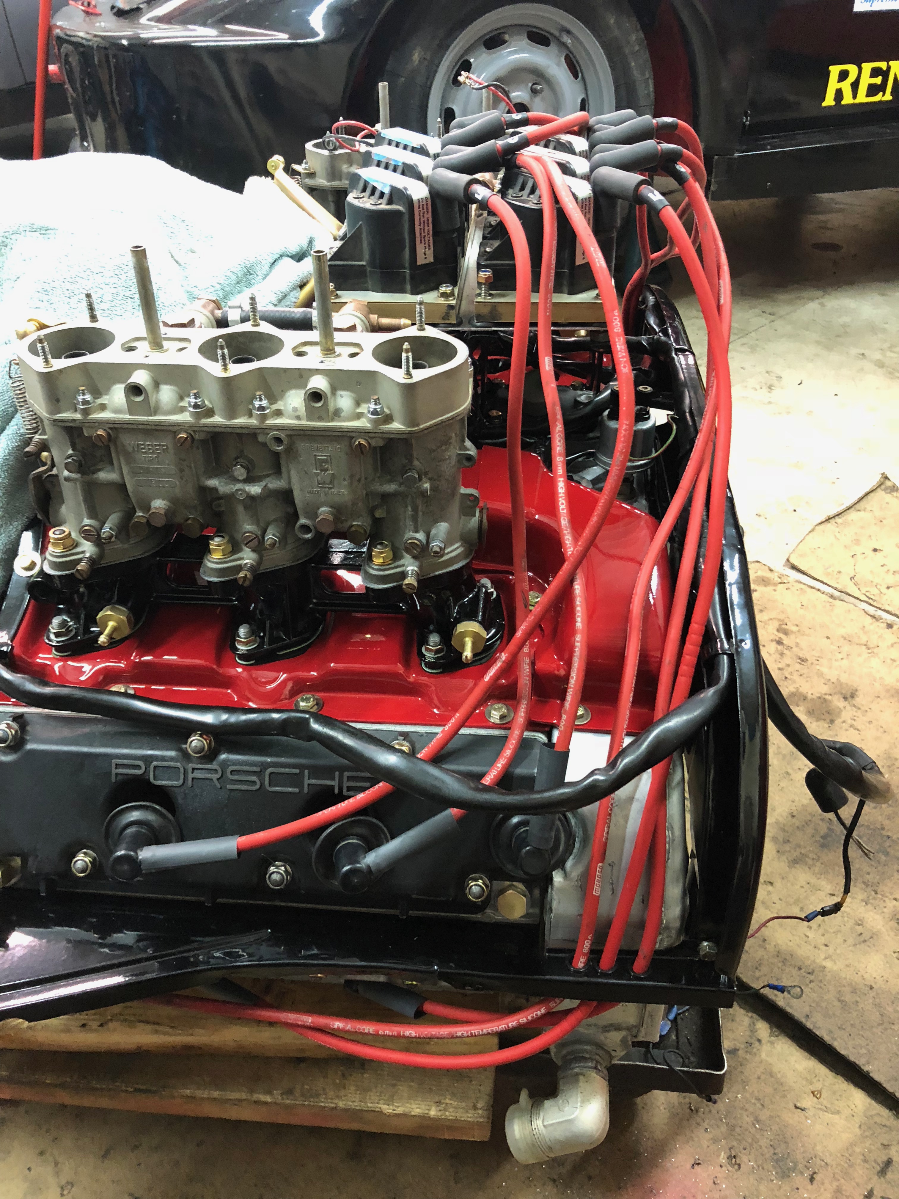

jfort   ended up fabricating a mount for the direct igniti...   May 31 2018, 10:50 AM
jfort   RE: Engine Rebuild   May 31 2018, 10:51 AM
jfort   RE: Engine Rebuild   May 31 2018, 10:52 AM
jfort   had to get the custom length wires through the tin...   May 31 2018, 10:53 AM
jfort   RE: Engine Rebuild   May 31 2018, 10:54 AM
jfort   note heat shrink on wire connections and the wire/...   May 31 2018, 10:55 AM
jfort   then we checked the axles as they had come apart w...   May 31 2018, 10:58 AM
jfort   lubed up   May 31 2018, 10:59 AM

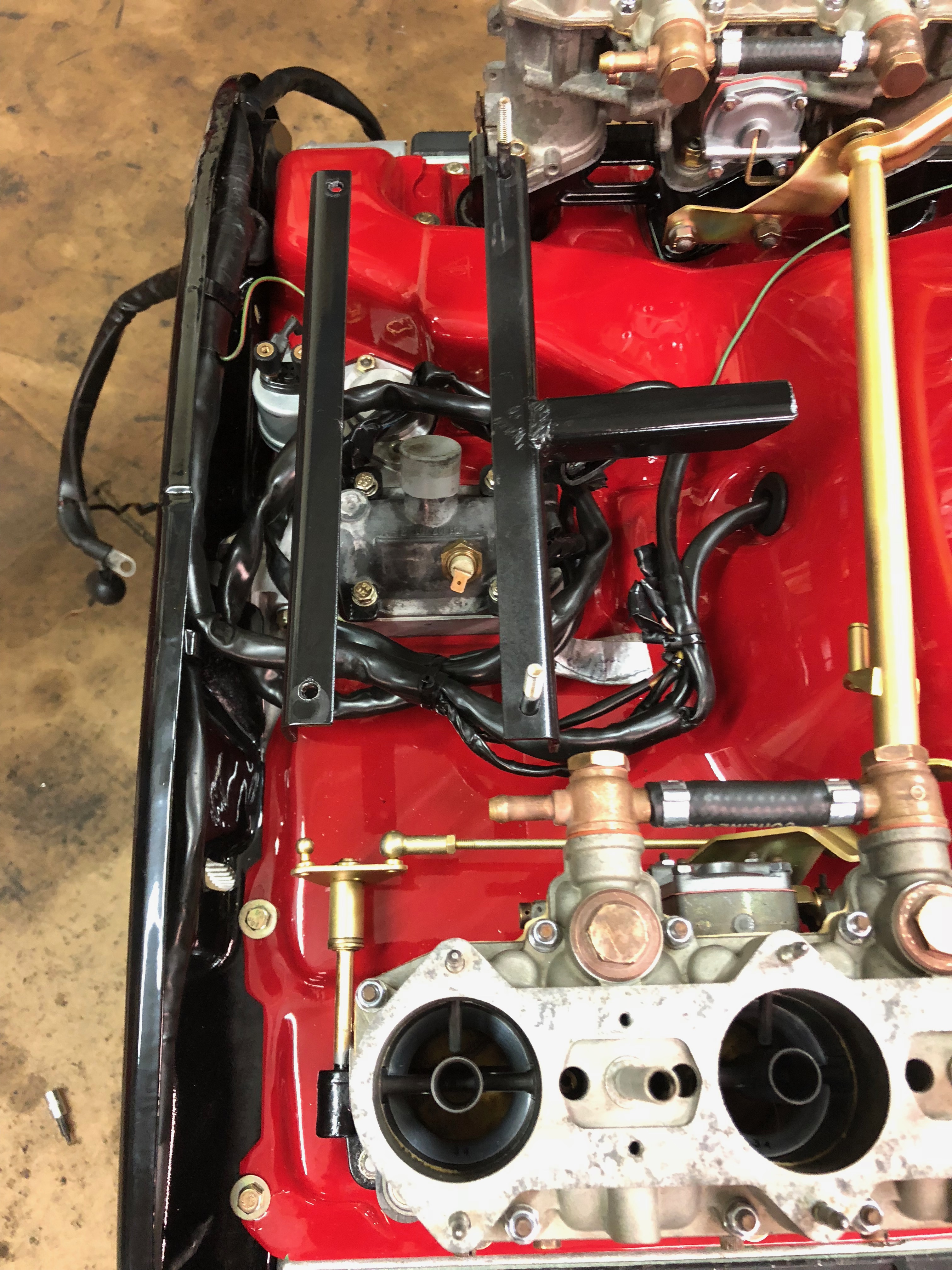

jfort   went in yesterday. took time to re-route oil lines...   Jun 12 2018, 09:25 AM
jfort   Engine installed last week. Thought we were ready ...   Jul 2 2018, 12:14 PM
jfort   wrapping this up. I replaced Webers with PMO. l c...   Sep 7 2018, 02:27 PM
