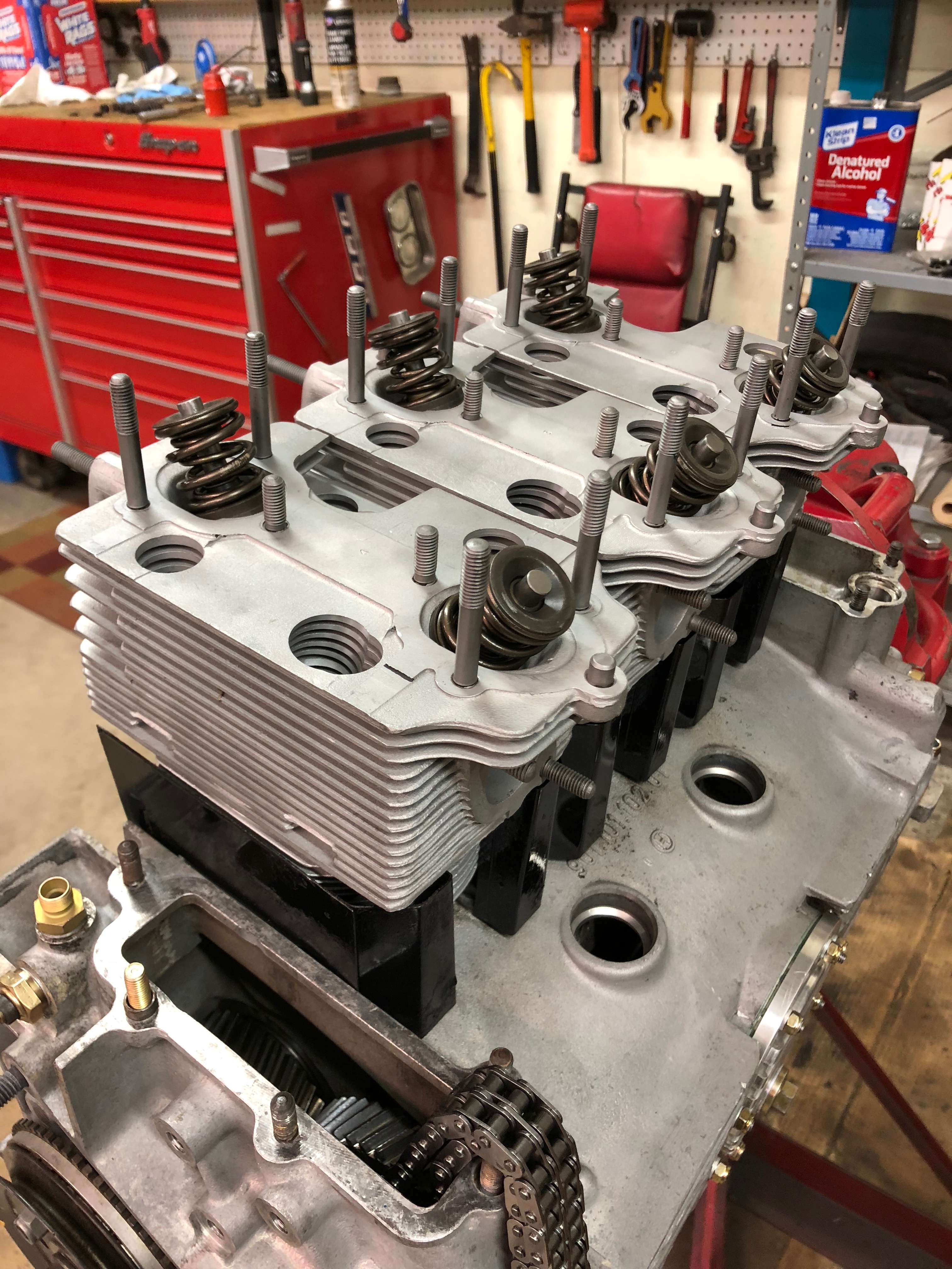

jfort   heads on   May 15 2018, 11:51 AM
