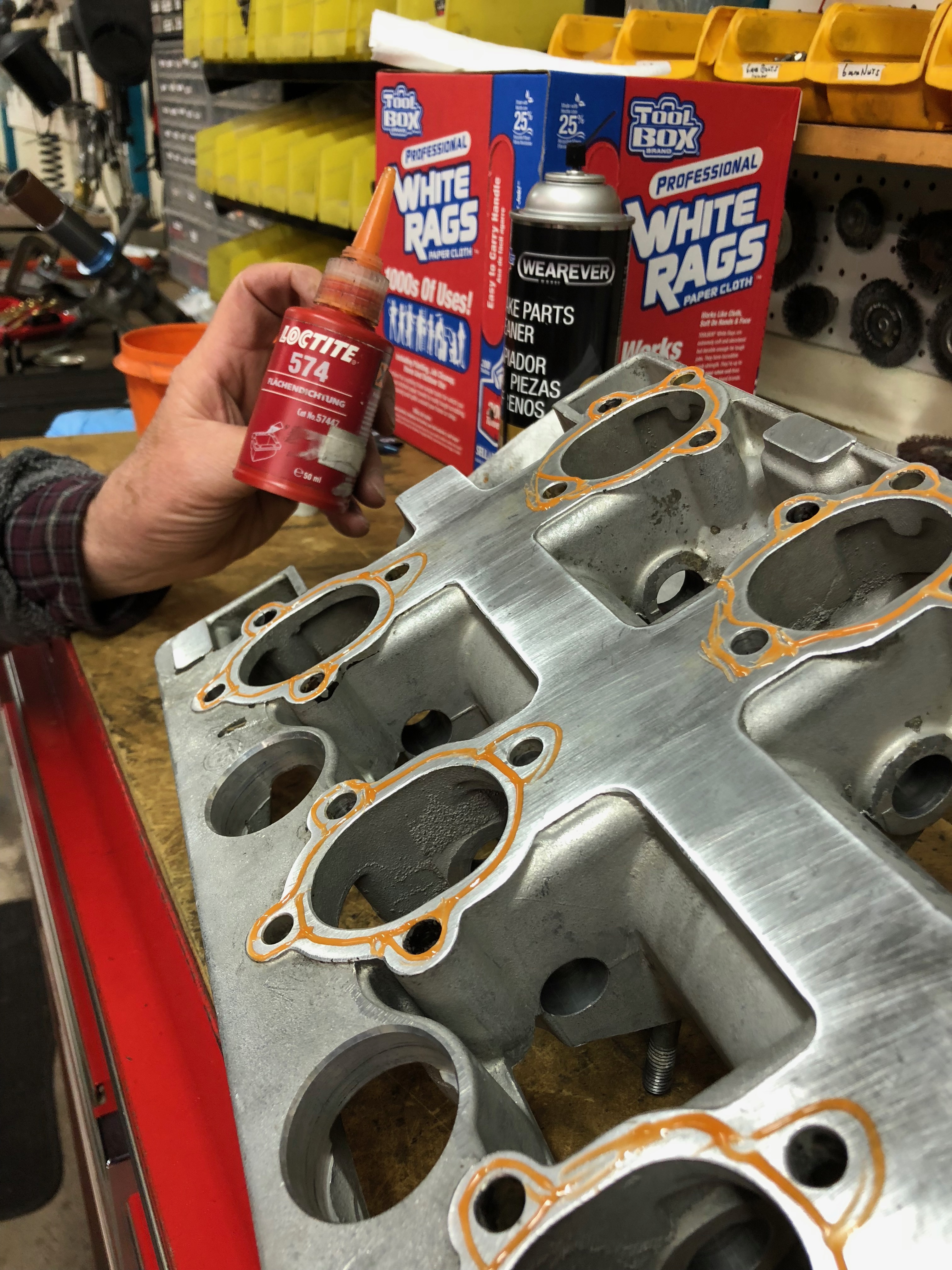

cam housing going on. Loctite 574 doing the sealing. better life through chemistryAttached Image
