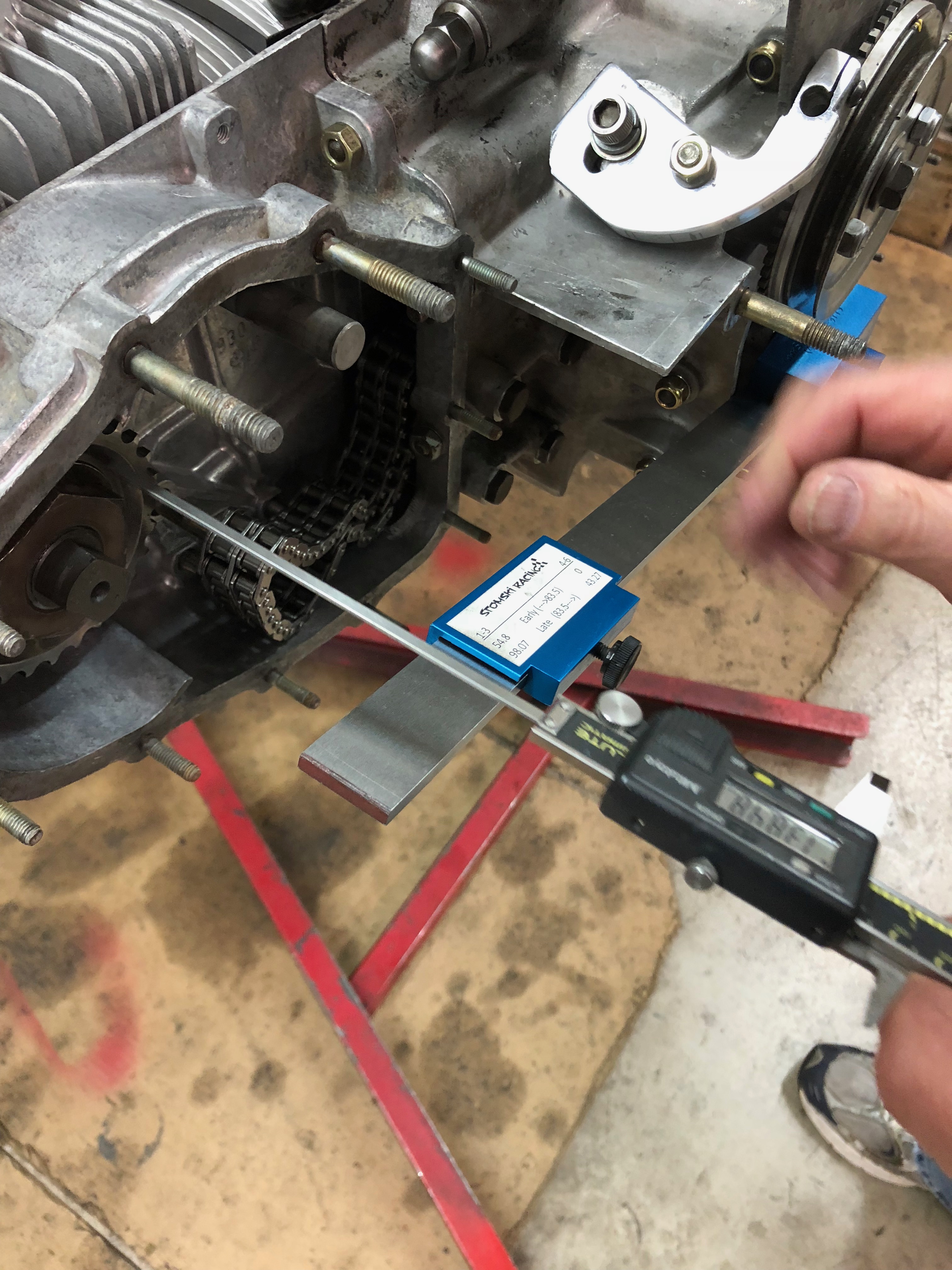

measure depth of and aligning chain sprockets. new chains

jfort   measure depth of and aligning chain sprockets. new...   May 15 2018, 11:56 AM
