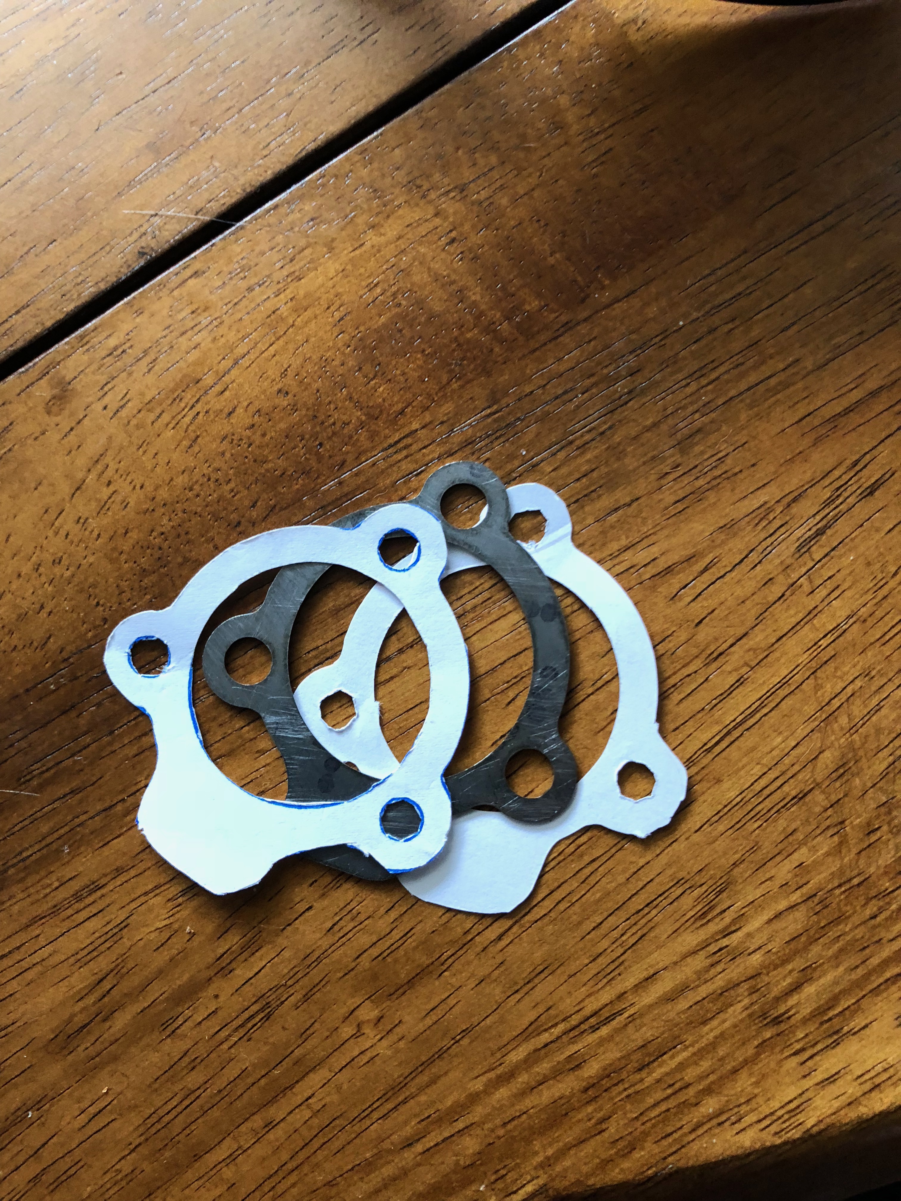

the intermediate shaft has a specified "play" fore and aft, which is controlled by a shim on the outside of the case. they don't make the shims anymore, at least that we could find. had shims made in 3 different widths. added paper and loctite to achieved required tolerance
