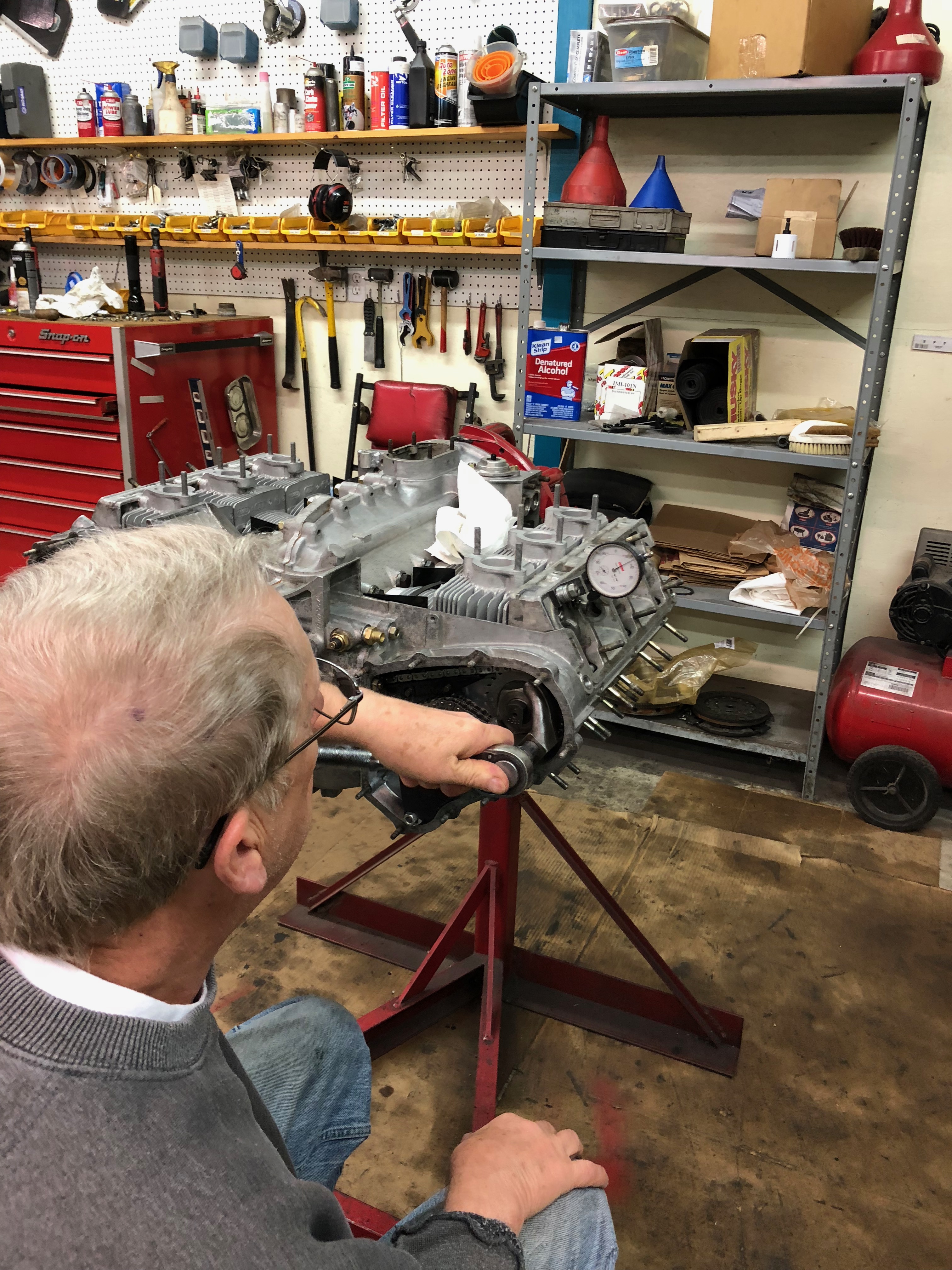

jfort   Spent the second day on the rebuild yesterday. Rec...   Jan 27 2018, 11:32 AM
mb911   Spent the second day on the rebuild yesterday. Re...   Jan 28 2018, 07:54 AM
jfort   We next had to determine the swept volume and the ...   Jan 27 2018, 11:54 AM
jfort   A post script. Getting to know Jay Kjoller is a jo...   Jan 27 2018, 12:01 PM
