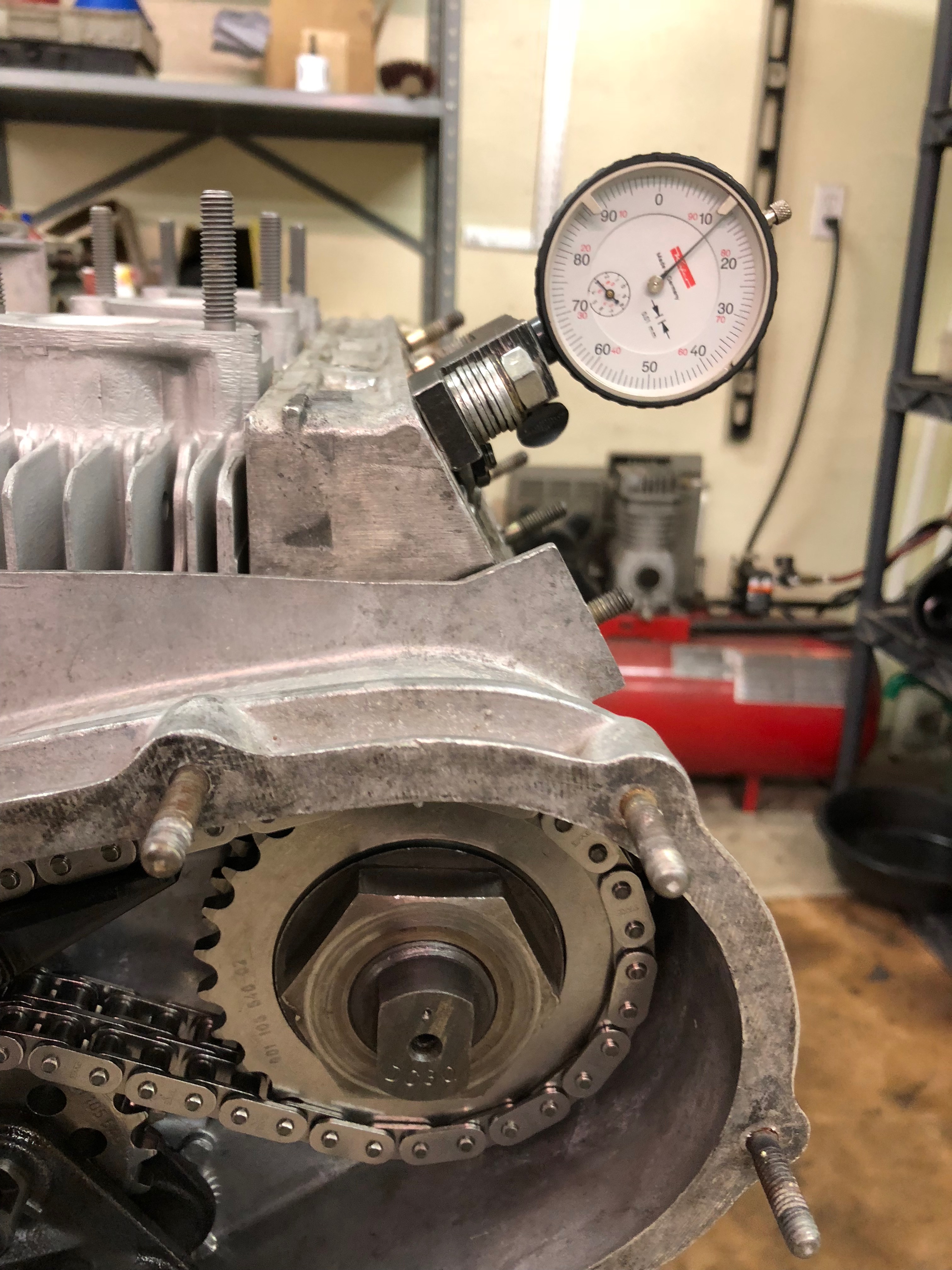

jfort   measure depth of and aligning chain sprockets. new...   May 15 2018, 11:56 AM

jfort   timing the cams took a lot of time. based on Dough...   May 15 2018, 12:02 PM
jfort   PERFECT!!   May 15 2018, 12:03 PM
