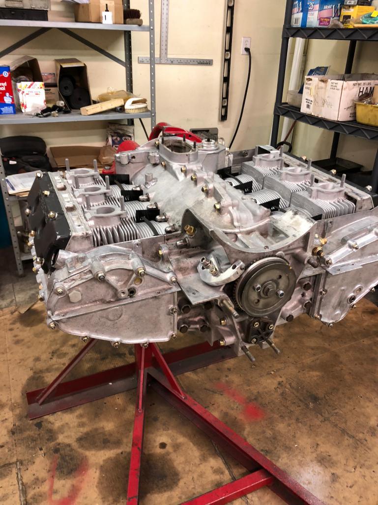

jfort   heads on   May 15 2018, 11:51 AM
jfort   cam housing going on. Loctite 574 doing the sealin...   May 15 2018, 11:53 AM
jfort   RE: Engine Rebuild   May 15 2018, 11:54 AM
jfort   measure depth of and aligning chain sprockets. new...   May 15 2018, 11:56 AM
jfort   the intermediate shaft has a specified "play...   May 15 2018, 12:00 PM
jfort   timing the cams took a lot of time. based on Dough...   May 15 2018, 12:02 PM
jfort   PERFECT!!   May 15 2018, 12:03 PM
jfort   lubed cam lobes, added chain tensioners and covers...   May 15 2018, 12:08 PM
