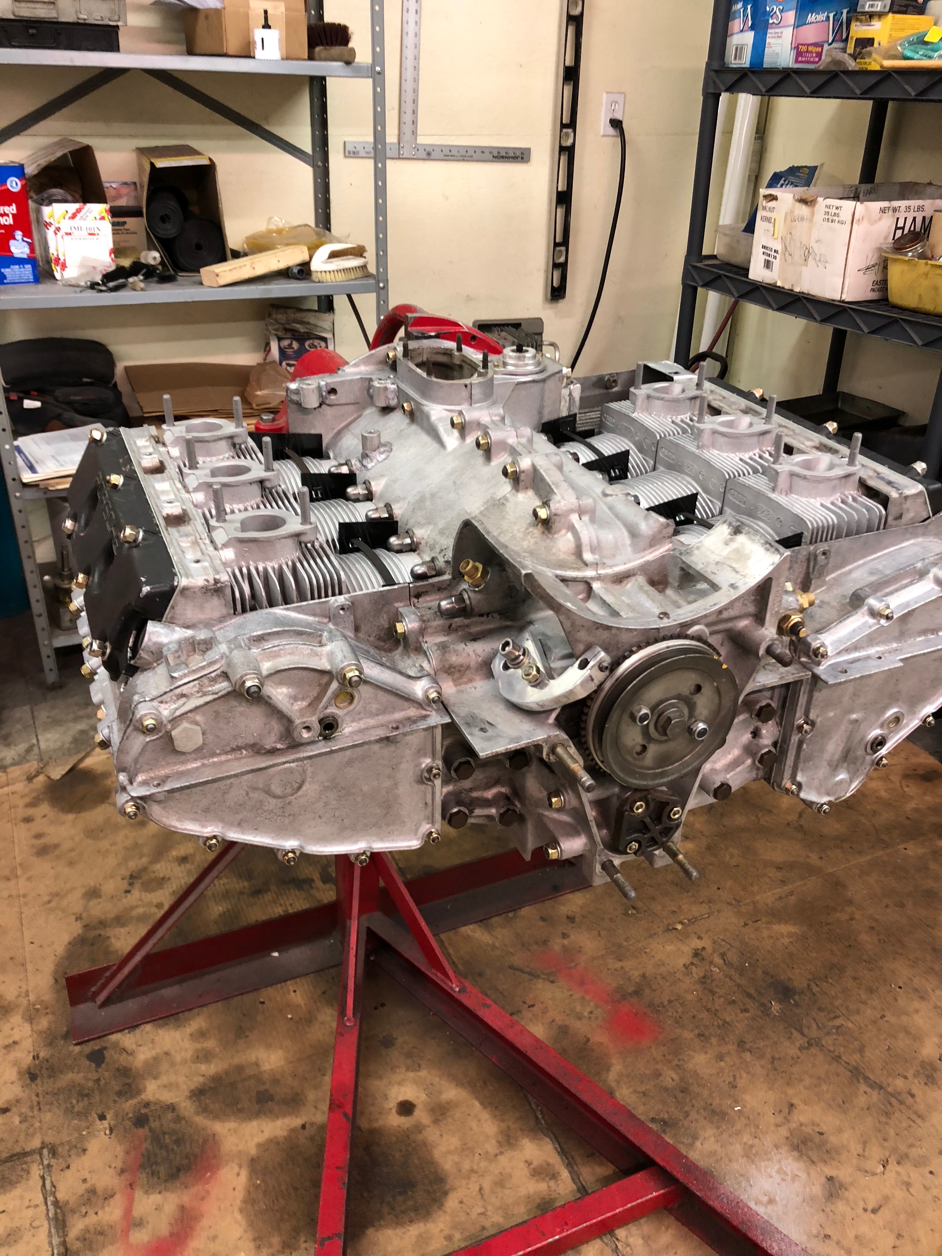

jfort   rebuilt carbs   May 15 2018, 11:40 AM
jfort   JE Pistons ready. 10.8:1. had to re-shape bevel to...   May 15 2018, 11:43 AM
jfort   re-nikasiled jugs to achieve correct tolerance   May 15 2018, 11:46 AM
jfort   pistons going in and jugs on   May 15 2018, 11:48 AM
jfort   RE: Engine Rebuild   May 15 2018, 11:49 AM
jfort   RE: Engine Rebuild   May 15 2018, 11:50 AM
jfort   heads on   May 15 2018, 11:51 AM
jfort   cam housing going on. Loctite 574 doing the sealin...   May 15 2018, 11:53 AM
jfort   RE: Engine Rebuild   May 15 2018, 11:54 AM
jfort   measure depth of and aligning chain sprockets. new...   May 15 2018, 11:56 AM
jfort   the intermediate shaft has a specified "play...   May 15 2018, 12:00 PM
jfort   timing the cams took a lot of time. based on Dough...   May 15 2018, 12:02 PM
jfort   PERFECT!!   May 15 2018, 12:03 PM
jfort   lubed cam lobes, added chain tensioners and covers...   May 15 2018, 12:08 PM

jfort   measuring and adjusting accelerator pump injection...   May 17 2018, 08:32 AM
jfort   getting close   May 17 2018, 08:34 AM
jfort   mating with the car starts Saturday   May 17 2018, 08:36 AM
