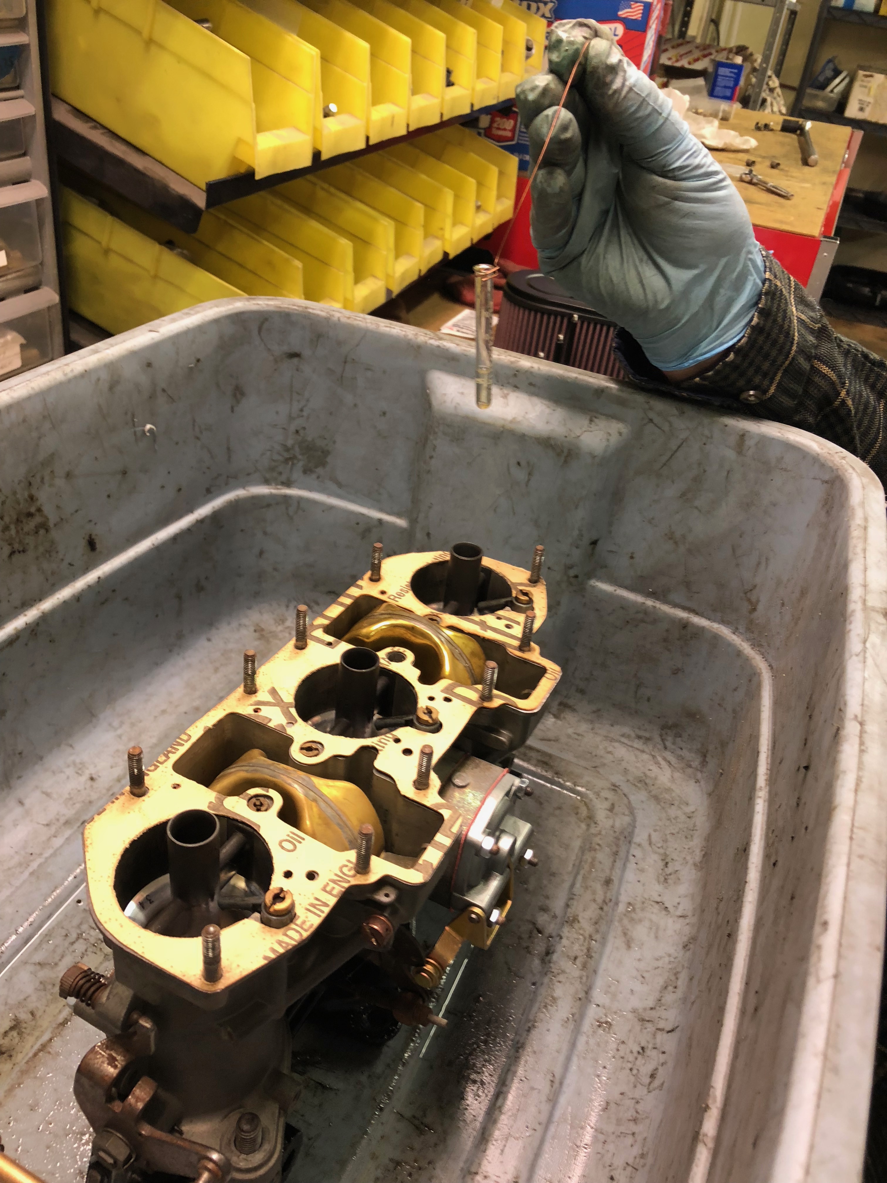

jfort   rebuilt carbs   May 15 2018, 11:40 AM
