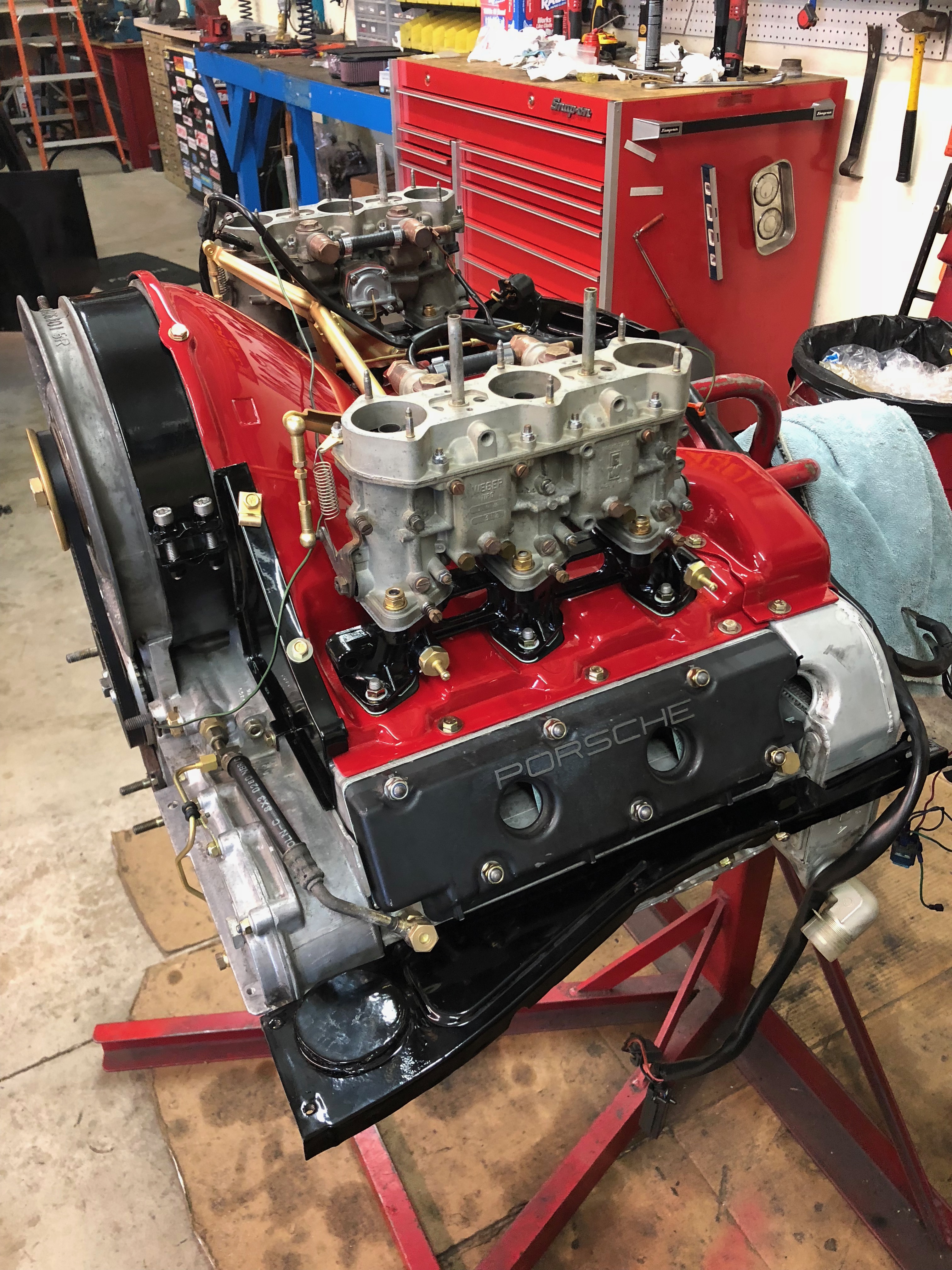

jfort   measuring and adjusting accelerator pump injection...   May 17 2018, 08:32 AM
jfort   getting close   May 17 2018, 08:34 AM
jfort   mating with the car starts Saturday   May 17 2018, 08:36 AM
