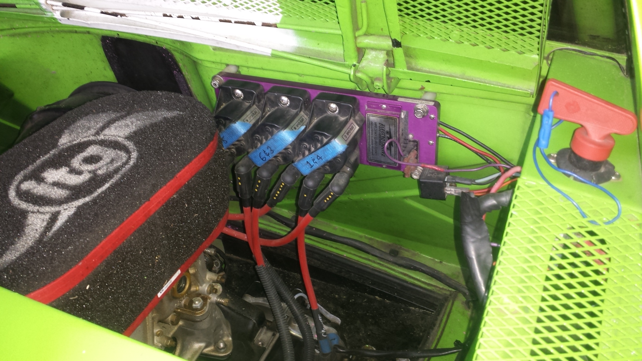

Anyone have any guidance as to where to mount the crank fired coils? There is not much room in the engine compartment.

QUOTE(jfort @ May 17 2018, 04:18 PM) *
Here's mine, works fine...Attached Image
