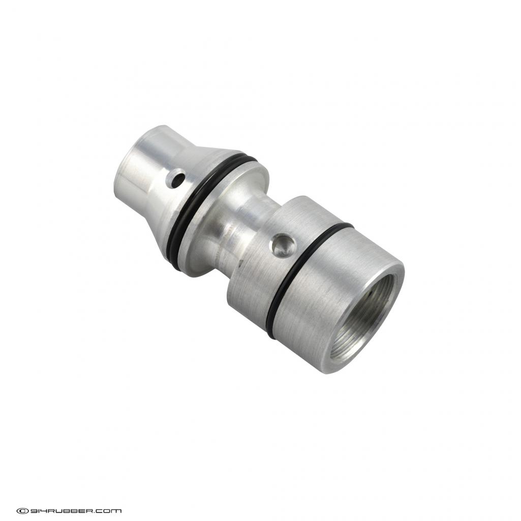

A pick will do it.
I have the seals if you need them. The seal yes replace. The aluminum washer you can reuse if it's not damaged.
The "new" part with all the seals is $65 if you want one. It has an extra seal so it will not leak.
