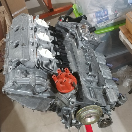

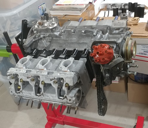

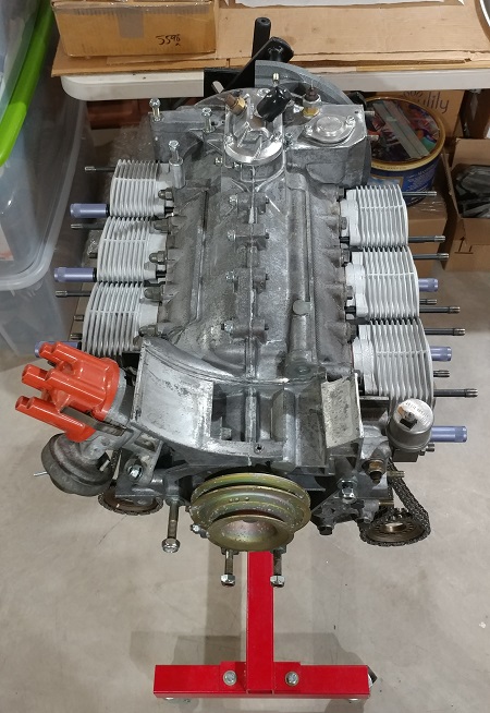

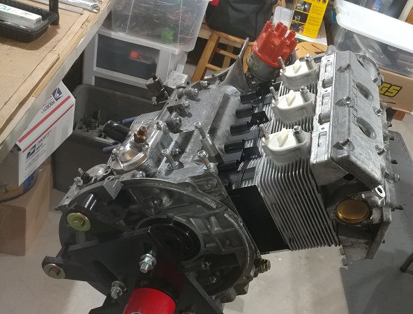

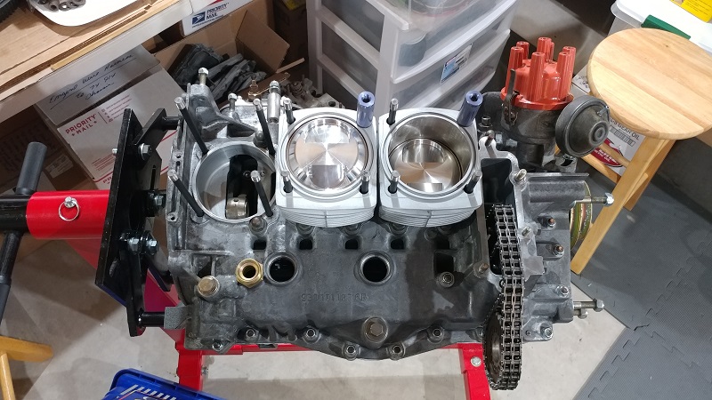

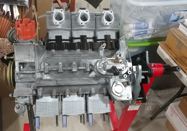

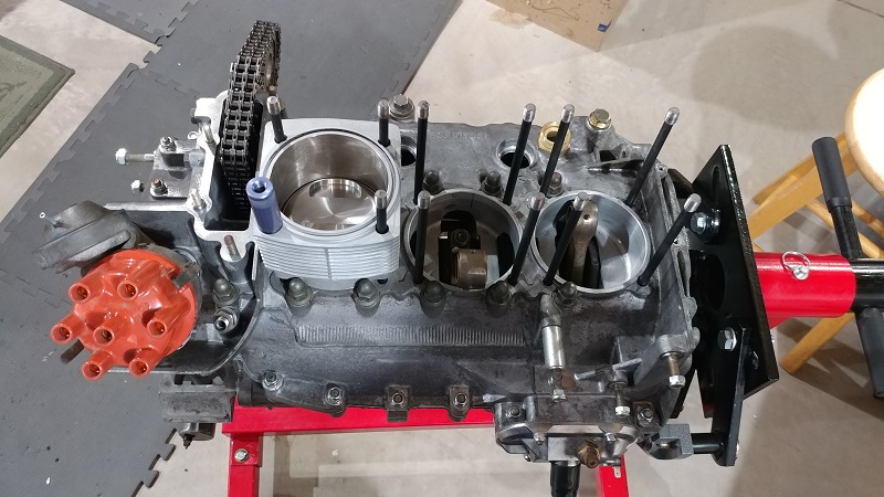

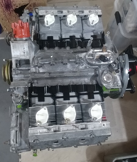

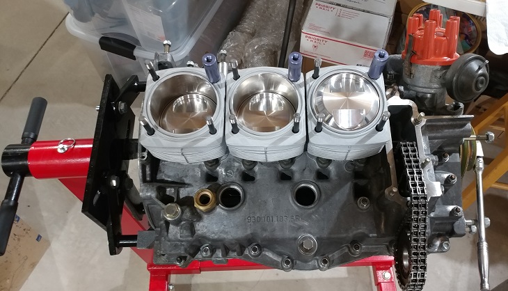

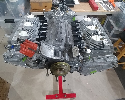

3.0 is almost done. Waiting on cams, rockers then set the timing.
(IMG:style_emoticons/default/beer3.gif)
