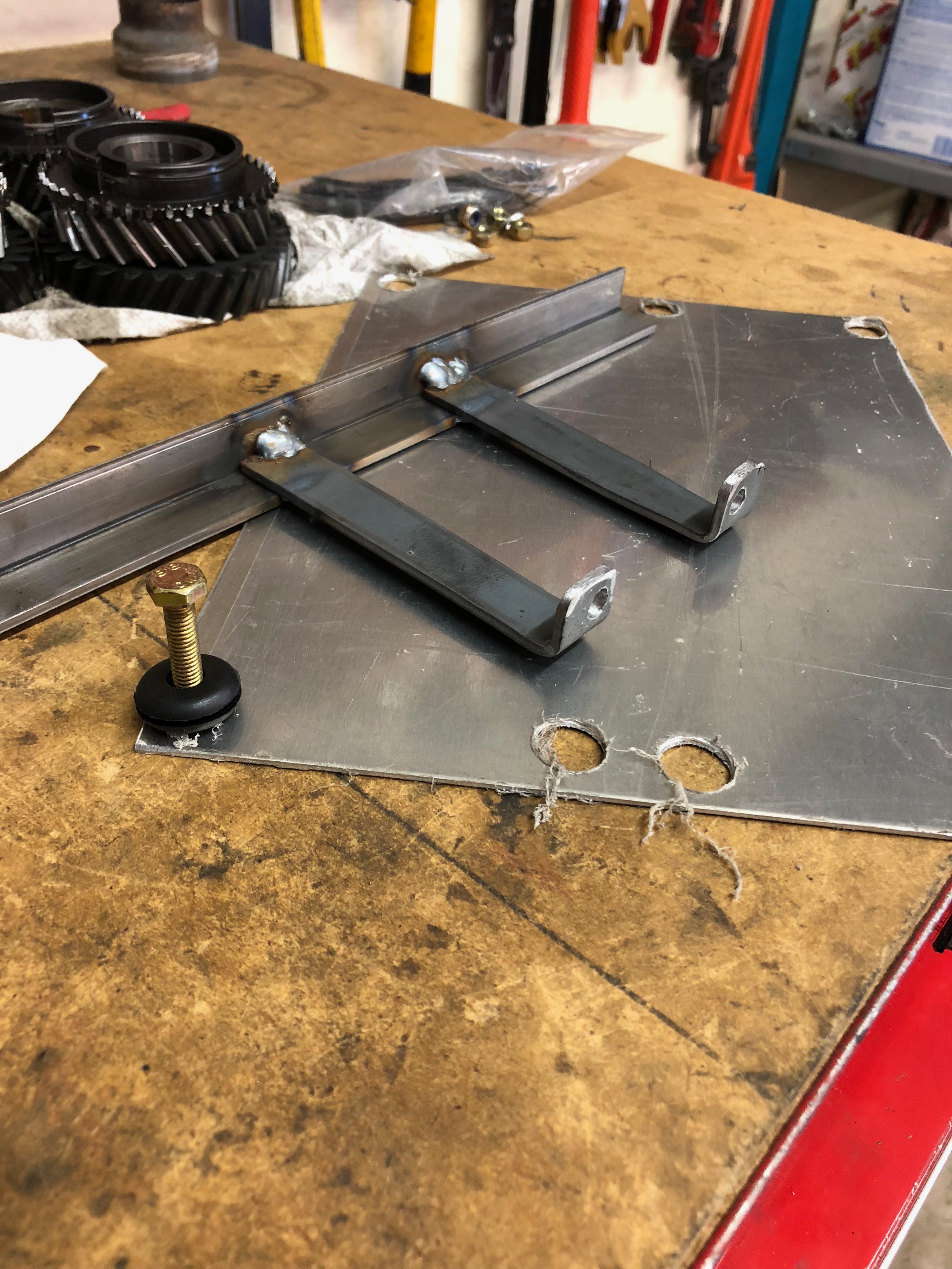

jfort   Anyone have any guidance as to where to mount the ...   May 17 2018, 06:18 PM
wndsrfr   Anyone have any guidance as to where to mount the...   May 18 2018, 05:59 AM
Larmo63   I mounted them in the trunk......Clewett system   May 18 2018, 08:28 AM
jfort   ended up fabricating a mount for the direct igniti...   May 31 2018, 10:50 AM
