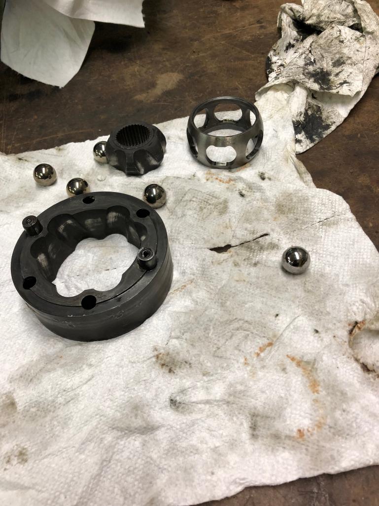

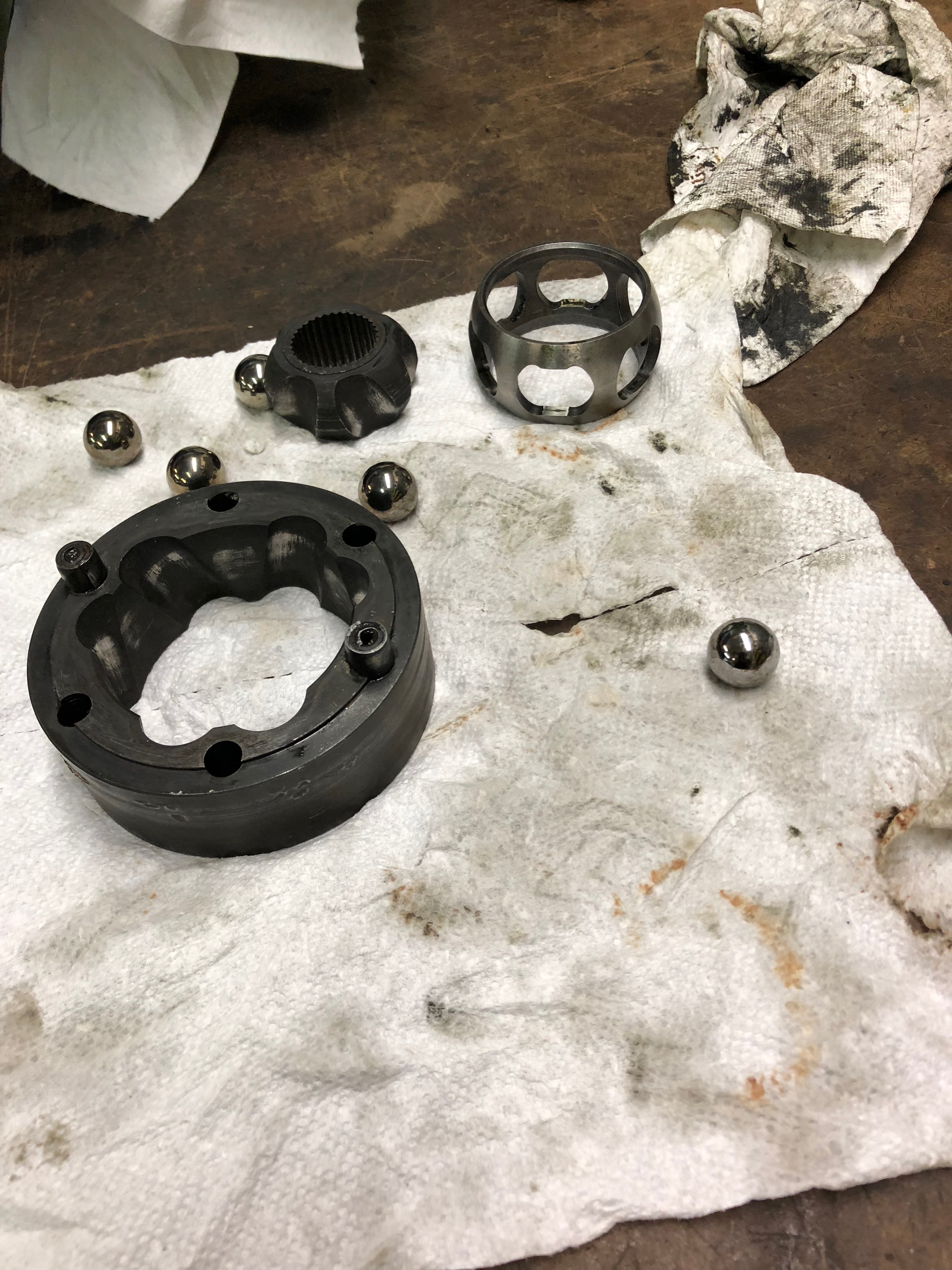

then we checked the axles as they had come apart when I removed the engine. Luckily, all the parts were there and in good shape (I found a bearing in the drive way a couple of days after the removal.) one of the boots needs replacement which has caused a delay.

jfort   then we checked the axles as they had come apart w...   May 31 2018, 10:58 AM
jfort   lubed up   May 31 2018, 10:59 AM
