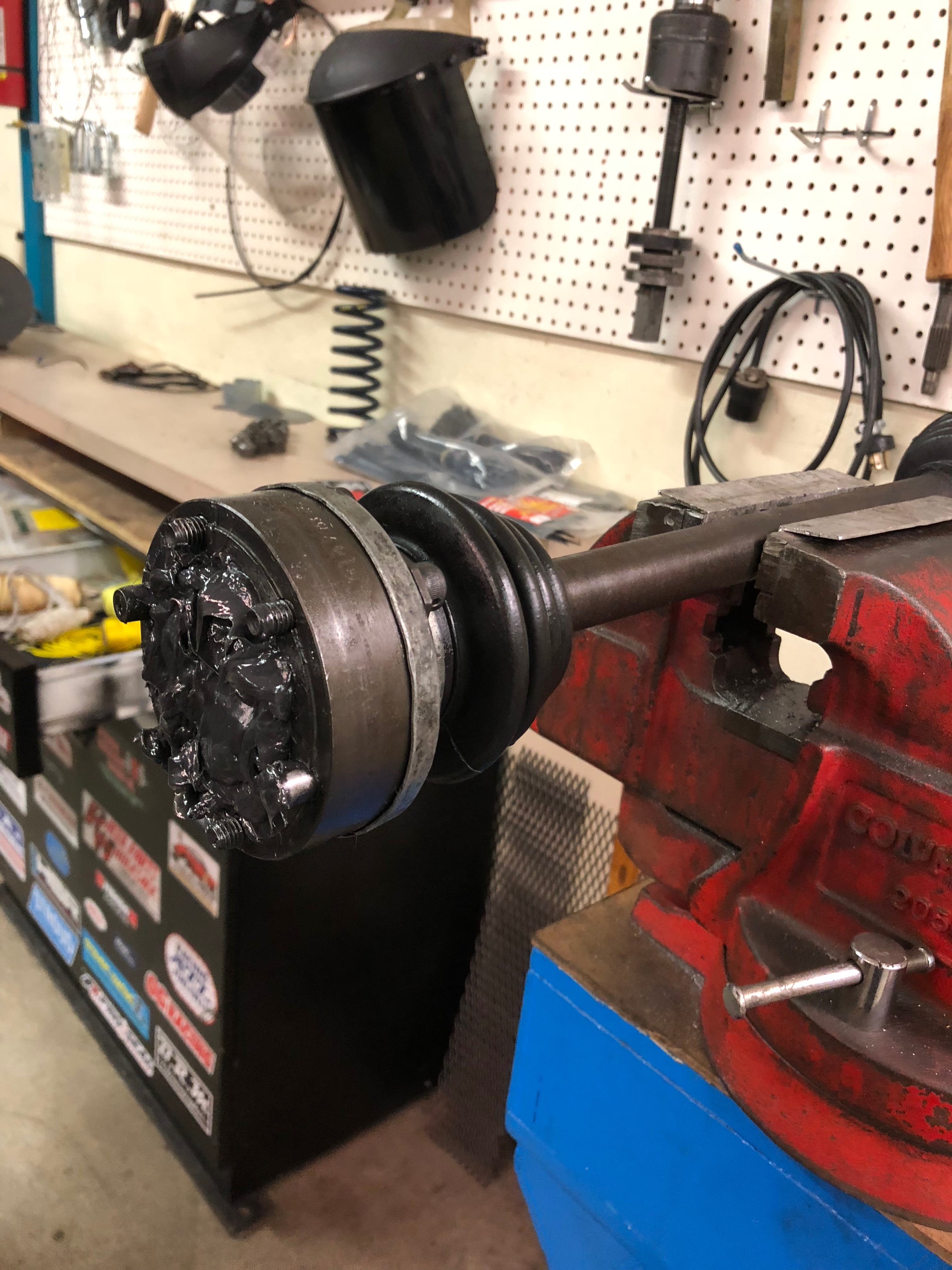

jfort   then we checked the axles as they had come apart w...   May 31 2018, 10:58 AM
jfort   lubed up   May 31 2018, 10:59 AM
