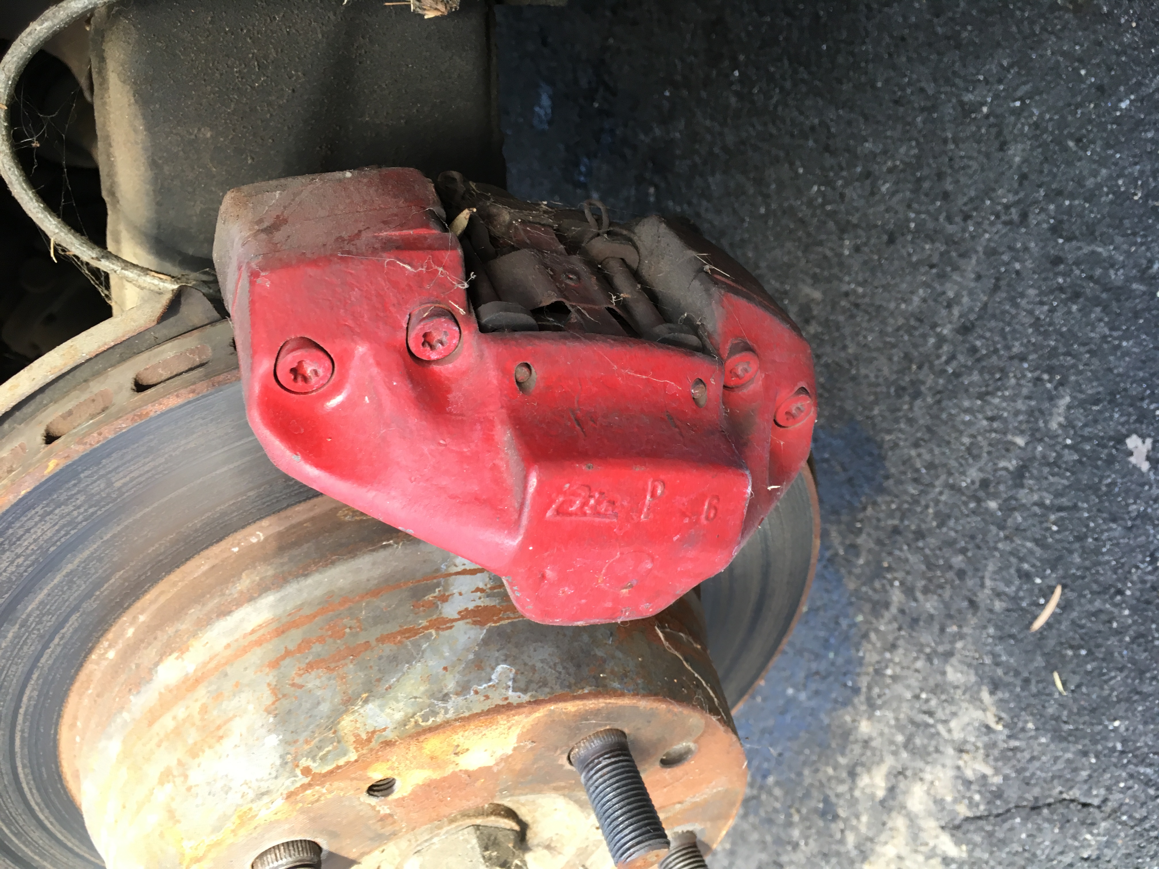

Hi Bob - it looks like I have a 911 front suspension and brakes on the front (aluminum cross member too) and 914/6 calipers on the rear.

Real 914-6 calipers? I hope so. That would be a nice score.
Or not....
