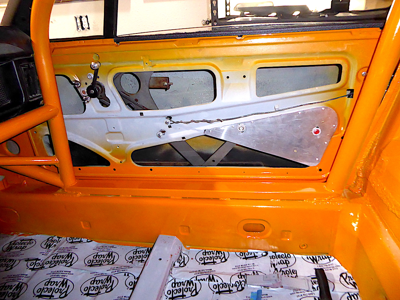

Not sure if this helps. I installed early doors on my 74, but kept the late glass and mechanicals. Had to add aluminum plate to support slide and redill holes around window crank. Worked out well. Best, MarkAttached Image

mlindner   Not sure if this helps. I installed early doors on...   Jun 3 2018, 06:44 AM

mlindner   altitude, funny, I got the early doors to rid of t...   Jun 3 2018, 09:52 AM
altitude411   altitude, funny, I got the early doors to rid of ...   Jun 3 2018, 09:58 AM
