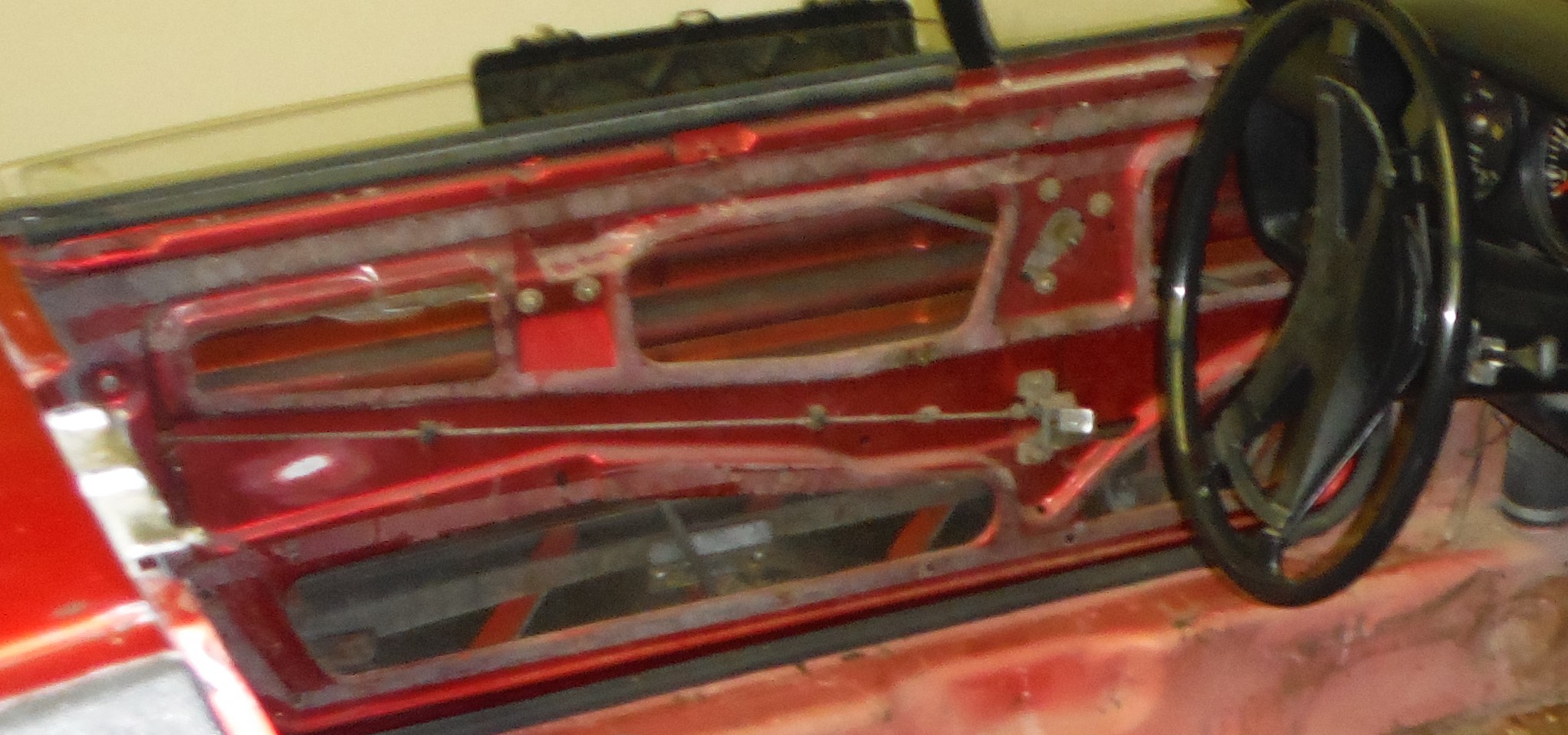

I drove my 6 into a tree
Posts: 1,306
Joined: 21-September 14
From: montana
Member No.: 17,932
I have late style doors with early regulators installed on my six. I wanted crash bars in the door but early windows to fit the top. Just need to drill a couple of holes. (Just in case anyone is researching in the future) *apologize for (IMG:style_emoticons/default/stromberg.gif) photo

altitude411   I have late style doors with early regulators inst...   Jun 3 2018, 09:04 AM
mepstein   We've installed crash bars in early 911 doors....   Jun 3 2018, 09:25 AM
mlindner   altitude, funny, I got the early doors to rid of t...   Jun 3 2018, 09:52 AM
altitude411   altitude, funny, I got the early doors to rid of ...   Jun 3 2018, 09:58 AM
