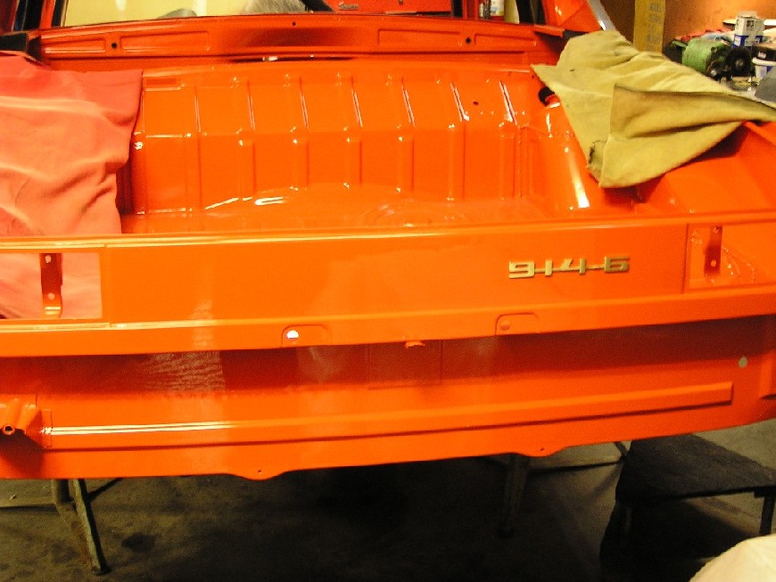

One more "dead" weight picture...
I filled the trunk button hole on the rear panel:

brant   One more "dead" weight picture... I filled the tru...   Nov 15 2004, 04:13 PM
