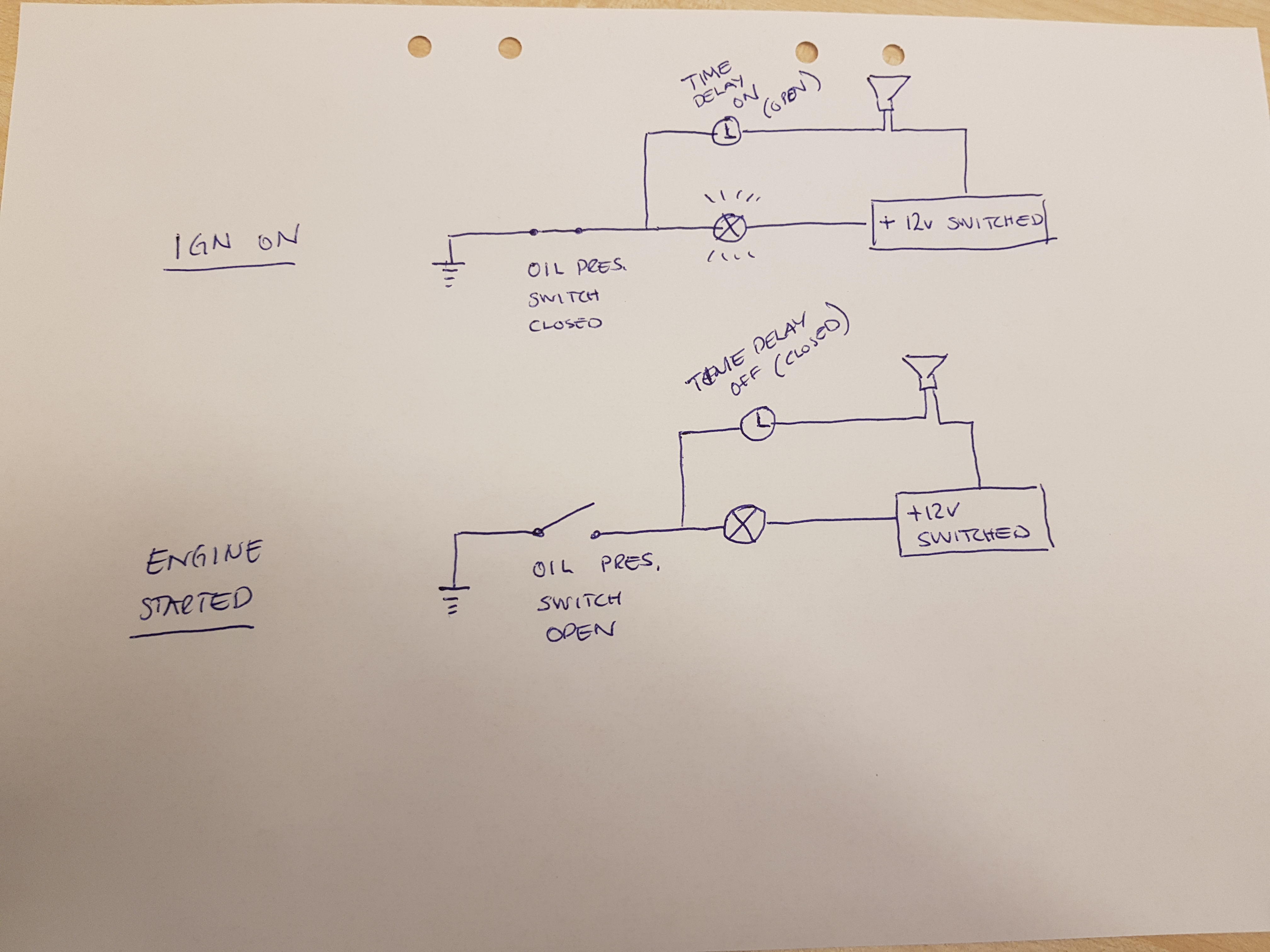

As I experienced a blown hose to my front oil cooler yesterday I'm now quite aware that just the little green oil pressure light isnt enough. I would like to add an audio warning aswell.
Has anyone done this? What parts did you use and how did you connect it?

Here is how i'm thinking to solve it, please let me know if I've screwed up somewhere... (IMG:style_emoticons/default/rolleyes.gif)

Mikey914   Not a bad idea. Run it off a separate circuit? Or...   Jun 17 2018, 09:09 AM
Cairo94507   Sorry to hear about the oil line. Hopefully no da...   Jun 17 2018, 09:28 AM
falcor75   I'm thinking it should be triggered by the oil...   Jun 17 2018, 10:29 AM
SirAndy   maybe have a 30-60 second delay Probably too long...   Jun 17 2018, 11:28 AM
SirAndy   ... just the little green oil pressure light isnt ...   Jun 17 2018, 11:26 AM
Maltese Falcon   If you can check out the circuit board in the gaug...   Jun 17 2018, 12:46 PM
falcor75   I found a kit for a timing module that is adjustab...   Jun 17 2018, 12:50 PM
worn   As I experienced a blown hose to my front oil coo...   Jun 17 2018, 06:42 PM
ajserrano   Here is a solution... :shades2:   Jun 17 2018, 08:21 PM
jim_hoyland   A VW/Audi chime relay will do the trick. They can ...   Jun 17 2018, 08:44 PM
falcor75   I got the kit i linked above and a 90db buzzer tod...   Jun 18 2018, 12:25 PM
porschetub   I got the kit i linked above and a 90db buzzer to...   Jun 18 2018, 02:44 PM
falcor75   Here is how i'm thinking to solve it, pleas...   Jun 19 2018, 12:41 AM
wndsrfr   If you're tracking the car, it's hard to h...   Jun 19 2018, 04:08 AM
falcor75   Well the buzzer is more of a beeper and a 90 dB be...   Jun 19 2018, 02:13 PM
Valy   What would you do when you hear the buzzer? Probab...   Jun 19 2018, 09:32 PM
DickSteinkamp   What would you do when you hear the buzzer? Proba...   Jun 19 2018, 09:46 PM
jd74914   What would you do when you hear the buzzer? Proba...   Jun 20 2018, 12:50 AM
falcor75   I'll stick the the plain old beep, adding more...   Jun 20 2018, 02:32 AM
