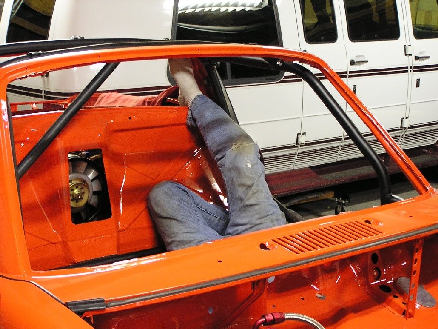

I had to take this one...
I'd like to call it "nap time"
but in reality its my dad fighting with the steering column:
