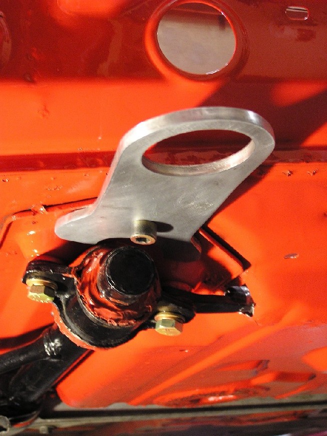

And this one is a shot of it from underneath...
Its only a test fit, and not tightened down in this photo.
This photo also shows my front bolt in brace from earlier in the thread.
You can also see the mueller bearings..
