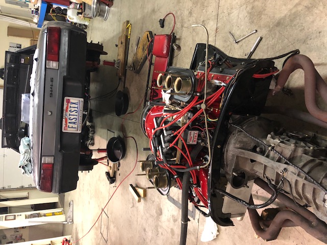

jfort   measuring and adjusting accelerator pump injection...   May 17 2018, 08:32 AM
jfort   getting close   May 17 2018, 08:34 AM
jfort   mating with the car starts Saturday   May 17 2018, 08:36 AM

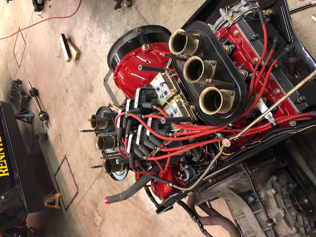

jfort   ended up fabricating a mount for the direct igniti...   May 31 2018, 10:50 AM
jfort   RE: Engine Rebuild   May 31 2018, 10:51 AM
jfort   RE: Engine Rebuild   May 31 2018, 10:52 AM
jfort   had to get the custom length wires through the tin...   May 31 2018, 10:53 AM
jfort   RE: Engine Rebuild   May 31 2018, 10:54 AM
jfort   note heat shrink on wire connections and the wire/...   May 31 2018, 10:55 AM

jfort   went in yesterday. took time to re-route oil lines...   Jun 12 2018, 09:25 AM
jfort   Engine installed last week. Thought we were ready ...   Jul 2 2018, 12:14 PM

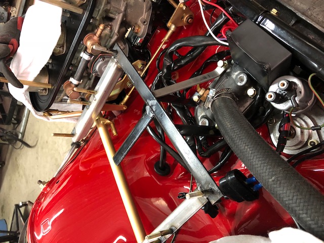

jfort   wrapping this up. I replaced Webers with PMO. l c...   Sep 7 2018, 02:27 PM
